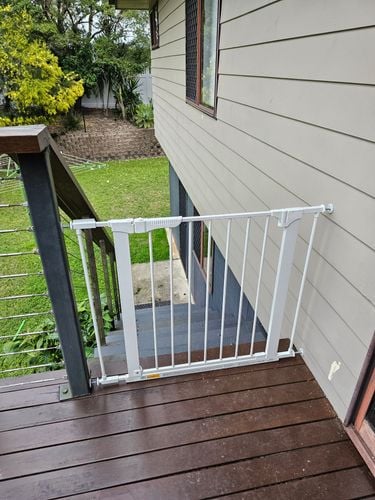

Hi all
Im looking to replace the baby gate with a more sturdy fixed gate. I have self closing hinges already but wondering what the best way is to mount the lock on the roght hand side? The minimum gap at the moment between the left post and weatherboard is 95.4cm and the height of the balustrade is 108cm.
Should I put in a post on the right mounted to deck if possible?
Thanks.

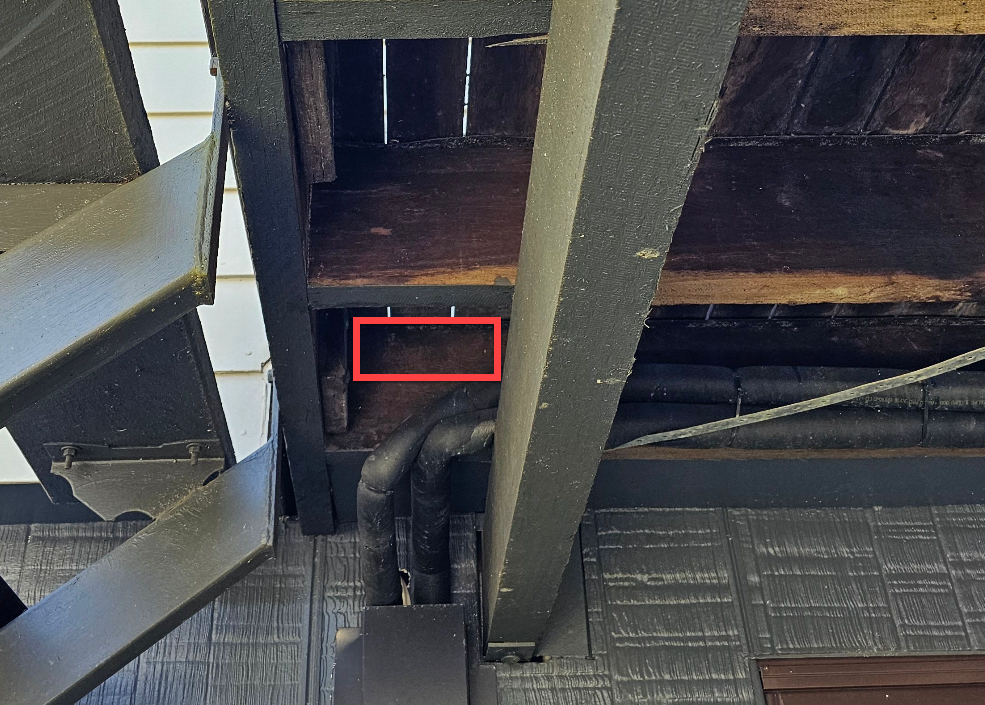

Thanks Jacob.
Pictures attached as requested. The post would be located up against the houses weatherboards that can be see in the photo.
Post would need to be attached to the framing member in the red box I believe. Would an anchor still work? Thoughts? 
Thanks.
Re: How to install a deck gate up against weatherboard?
Hi @Hughonidas,
I'm assuming they are hot water lines, which would make it a bit more tricky.
Is there any gap above them? Say 70mm or so?
A post anchor would still work if you can attach a piece of H3 timber framing to the side of the joist so that there is solid material beneath all four screw holes in the post anchor. If you could have two 100mm batten screws into the existing joist and then mount a 70 x 35mm Outdoor Framing H3 Treated Pine to the outside of the joist, then use two 50mm batten screws into that timber block, then that should hold well enough.
If there is no room above these pipes, then we might have to rethink our approach.
Let me know what you find.
Hi Jacob
Thanks for the help thus far. Another pic for more clarity on clearances. You can see the gap to pipes, less than 70mm. As well as about where the post will go on the far side of the deck.
I'll take a look at post anchors today and additional timber and screws to get it done.
Thanks.
Hi @Hughonidas,
How much clearance from the pipes do you have here?
As long as you can mount a block of timber that you can drive a decent-sized screw into, you should be in business.
Assuming the decking boards are somewhere around 20mm thick, then a batten such as this 42 x 42mm 2.7m Pre-Oiled Merbau Solid Screening would give you enough depth to drive in a couple of 50mm screws.
Let me know what you think.
Hi Jacob
Working with about 65mm clearance there so above solution should work.
