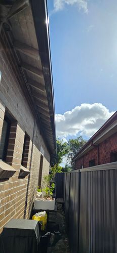

I would like to put a diy retractable plant shade cover down the side.
I've thought of options but would it possible to extend a small timber frame from the existing eaves over to the colourbond? I was going to do about 6 m and screw into the roof joists(?), 70% shade which I could retract if really windy. It'd be about an 800 mm extension. 
Am I kidding myself?  Thanks for the help.

It's entirely possible to construct something similar to what you have described. However, you need to remember that a Colourbond fence is not designed to have anything attached to it. So, although it might be able to support your structure, it should not be used as an attachment point if high-winds are expected.

I realise now that my post sounds like I want to attach it to the colourbond. Sorry. What I meant was a structure that extends of the roof, at the same angle and comes out as far as the line of the fence. Essentially, it'd be an extension of the underside of the roof by about 800 mm.

The awning that I've linked to above is the closest product I can think of that matches your description. Perhaps you could custom-make an awning, but having it retractable might be difficult to create.

I wonder if you could adapt one of these retractable outdoor blinds. You might be able to make or have made up supporting fixtures at either end to stand it further of the house at the lower end?
