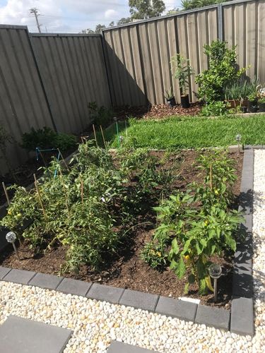

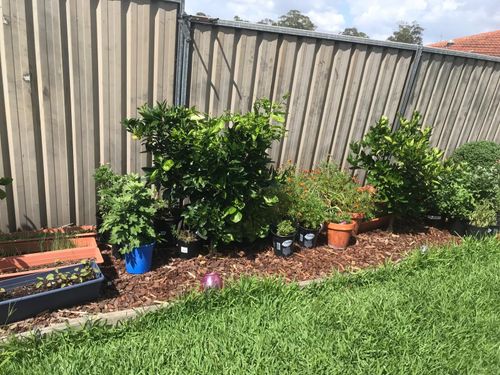

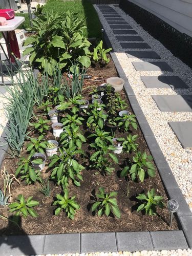

Please help me with material, eqipments and process to install Shade cloth on vege patchs and garden beds adjacent to fence in backyard.
Vege Patch Size
1) 1.8 X 2.5 Mtr
2)  1.4 X 4.7 Mtr

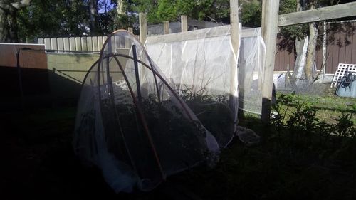

This was the first way I tried it, two pieces bent corner to diagonal corner, the way I described it would have been better.
As you can see the weight did pull it out of skew.

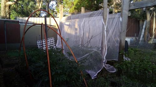

Five to six months later it was still standing. Issues I had is that I just wedged the conduit into the garden bed, no reo stakes. It did protect my planst from the birds. But because I had gone diagonally it was harder to maintain weeding.
Note these are from 2017-2018 and I stopped using the bird netting afterwards as I was concerned a little bird would get caught in the netting when I wasnt around. Shade cloth comes in various strengths and is a lot finer so no issues for the animals/birds.
