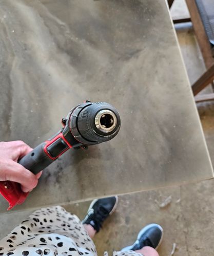

thanks!!!!! embarrassing question- what type of drill is this? I think it's the wrong type but I'm not sure

That dosnt look like a hammer drill 😕 It could be an impact drill but they are not built to drill through concrete/brick.
I dont have a battery hammer drill as I prefer a wired one.
Here is a cheap hammer drill ozito 710w hammer drill That should do must small type jobs you would need to.
You can easily see if a drill is a hammer drill buy checking the top of most drills and there will be a dial with a picture of a drill or a picture of a hammer.

As @Dave-1 mentioned, that's likely a drill driver for installing screws and drilling holes in timber and metal. Some drill drivers do come with a hammer function, like the Ozito PXC 60NM Hammer Drill Kit, and that could potentially be one. Can you check the left-hand side to see if it has a selection for the hammer function? Post a picture if you need.
nope no hammer function looks like that's going on the shopping list also LOL
Surprisingly handy drill to have, hammer drills generally have the drill and hammer drill function btw.

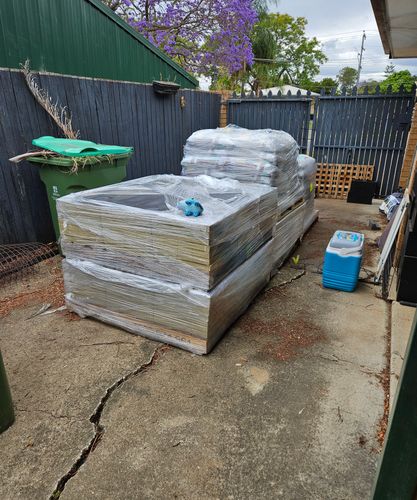

Check out my patio so far - final coat of paint complete - pavers and sand delivered ready to go for the final push!!!
