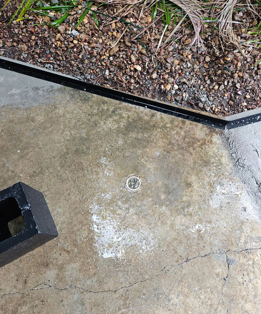

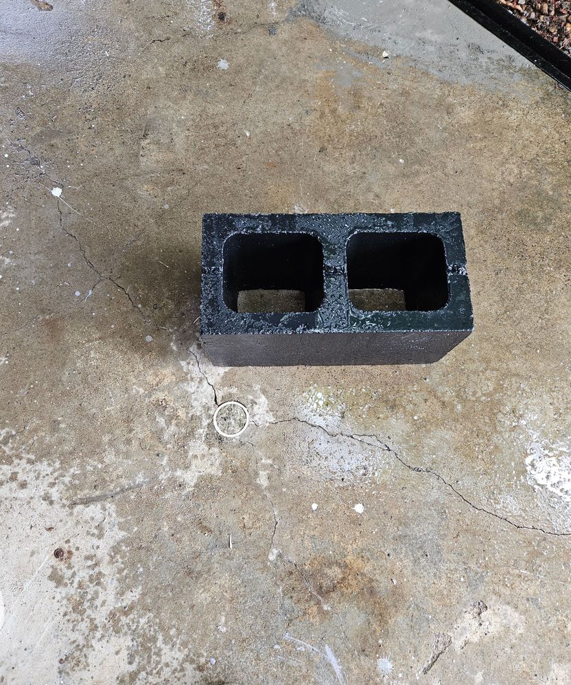

Hey, just a question. I was talking to a mate about paving and using your paving as an example and I moticed that round marking bottom right of your pic?
Is that a drain inspection point? If So it may be an idea to draw a plan of your patio and mark any services you have so you can come back if needed.
you mean these? no idea what they are they appear to be old pipes cemented in I don't think they're important

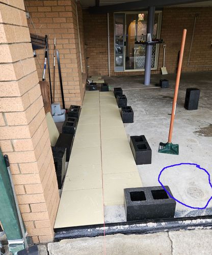

I was looking at this, not sure if its just something that has left a mark or a drain inspection point. The other ones you have shown are what you say they are ![]()
Was just wondering what the circled (badly) blue thing is? ![]()
looked like another cement filled drain its gone now so hopefully nothing important there was no way to open it

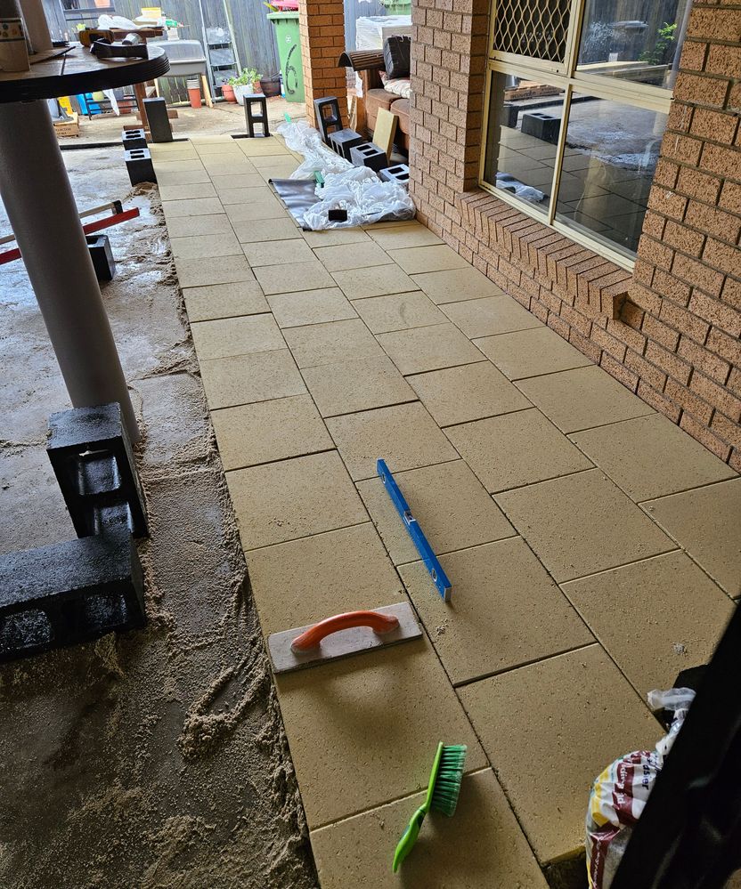

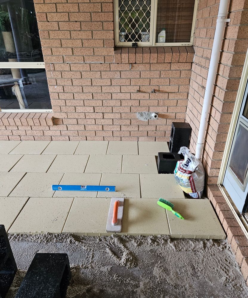

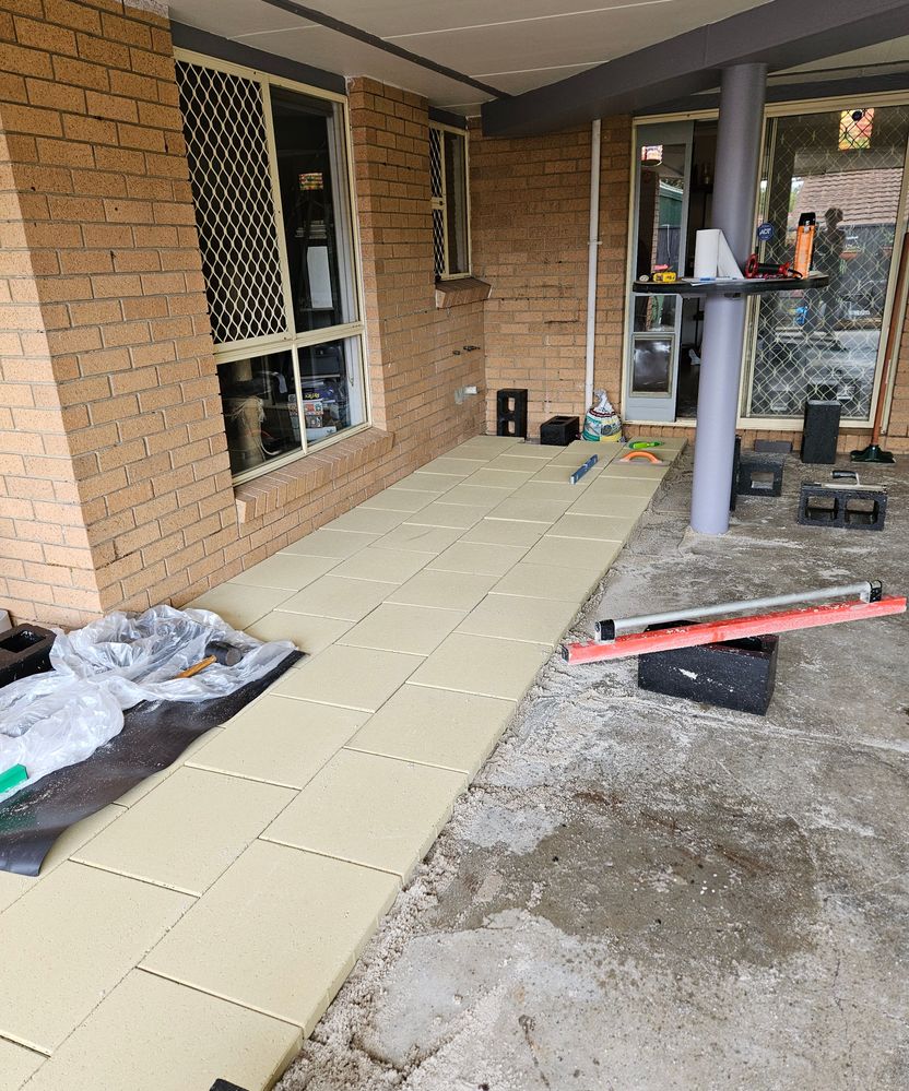

i have NOT missed my calling as a landscaper 2 rows a day appears my limit if I don't want an injury or to get slack
It's an uneven result but for a first job I think it's OK
Hi @lakiita
From the photos you posted it's looking pretty good. I'm looking forward to seeing it complete.
it's actually turning in to a great project for learning with - I feel like I'm really getting confident with the level screed and trowel still a little crape with the tamper though and I've yet to figure out how to protect my back and not bend over whilst picking up pavers in the middle of the pallet. I can't believe I'm not even half done my patio is insane!!!

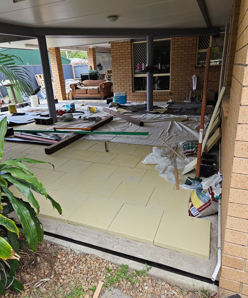

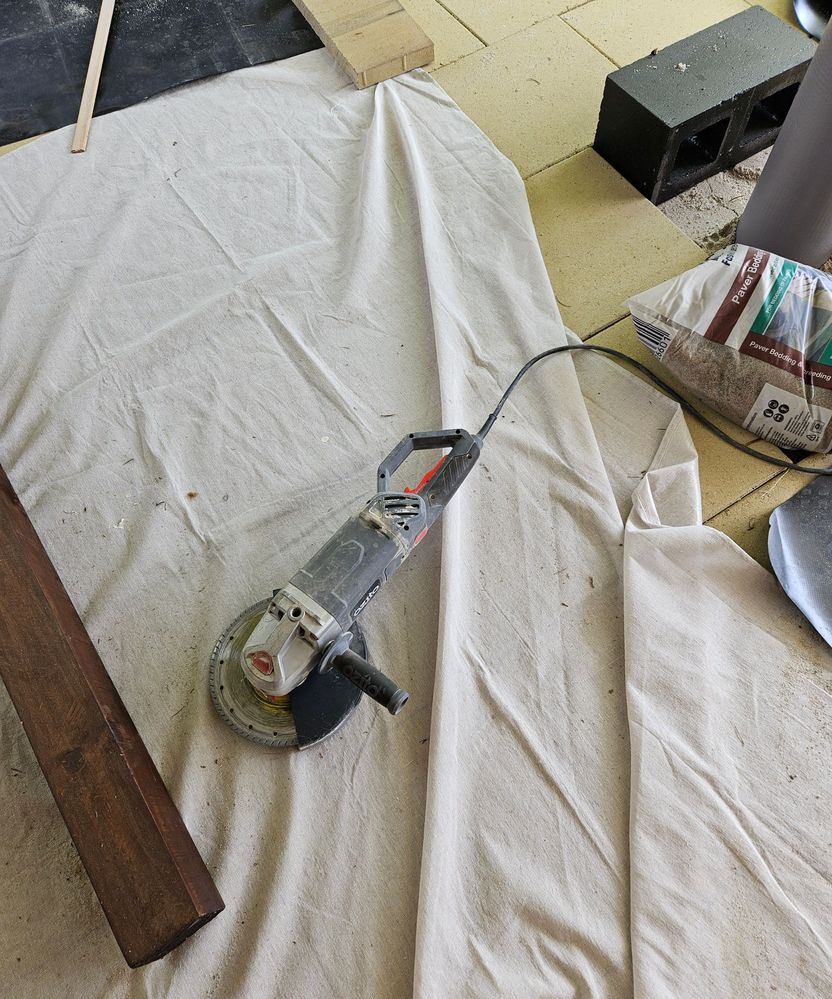

pavers are all down and today is power tool day. My Dad is doing the complicated. cuts but he wants me to try the simple ones and has left me his MONSTER of a circular saw. I'm REALLY nervous about using it and. ld use some moral support. Here's where I'm at atm - all the mess is just coz I'm trying to keep the pavers covered before I seal them.
Looking good @lakiita. Was your father able to show you how to use the saw and stick around while you got familiar with it? I have concerns with you launching into using a tool that you are not familiar with and I'd recommend you watch plenty of YouTube videos on paver cutting before you do. WHat type of saw is it? Is it a circular saw with a masonry blade or a table-mounted brick saw?
yeah he gave me a tutorial and I've cut one already without incident
I'm sure it'll be fine I'm just a Lil clumsy and an ED nurse - sometimes knowing ALL the things that can go wrong is intimidating
