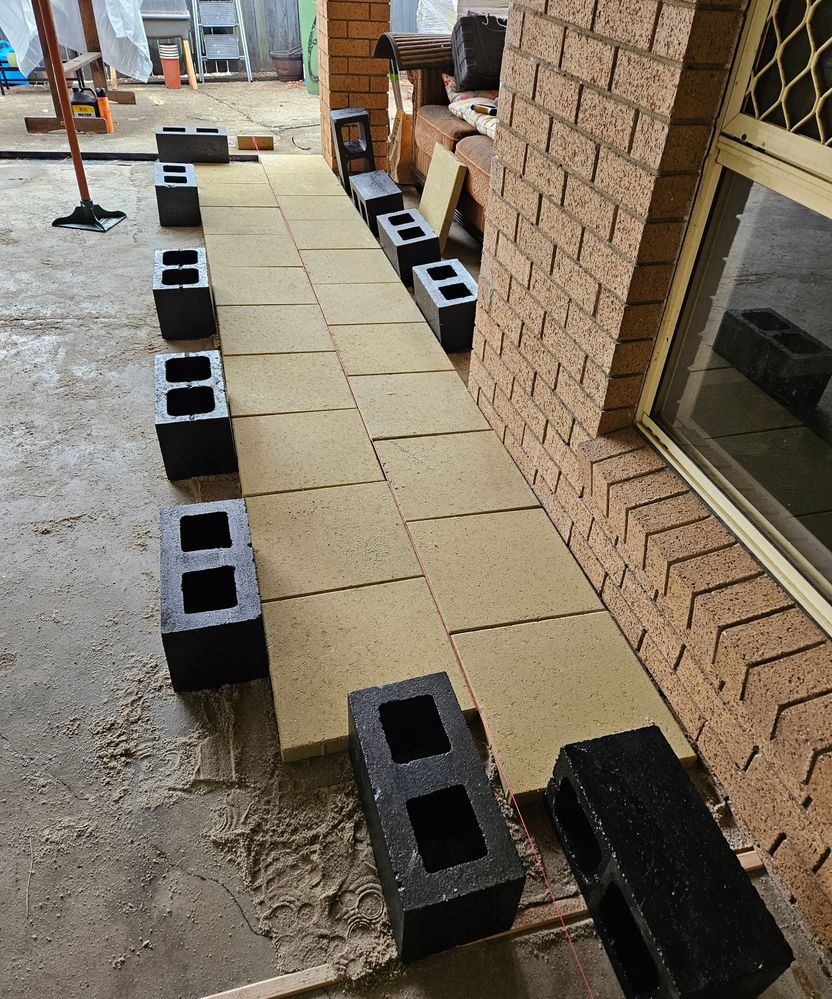

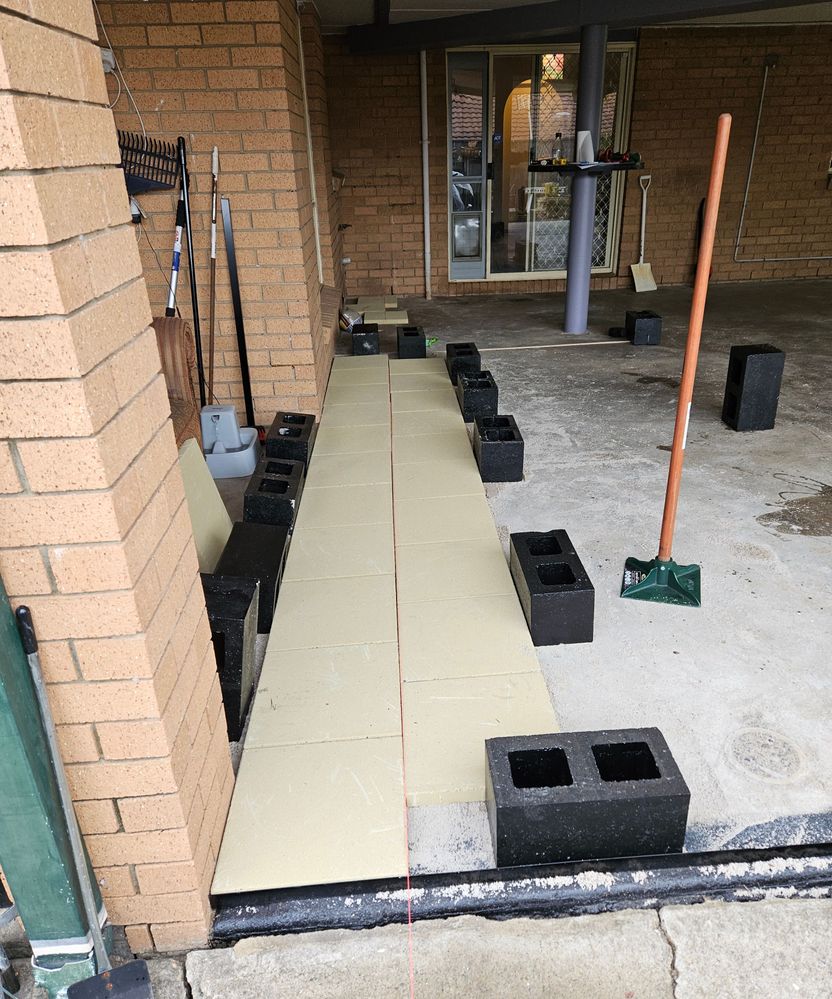

first few rows complete it's not perfect but it's a start we completed all the edging today as well and a mini cement pour for a corner that needed it - the besser blocks for my bench are coming in super handy as a way to do this in sections - hoping to finish off these two rows tmrw and maybe another two. It hasn't been as bad as I feared but my Dad was helping and now Im solo which is terrifying. Obsessively levelling each paver with the one beside but I think there's still a tiny bit of variation- hopefully not too noticeable or I'll be starting over!!!

Thank you so much for that update on your paving project. It's a very promising start. I recommend using more builders line as a guide to keep your pavers lined up. Just keep in mind that you always have an opportunity to fix a pavers level as long as you haven't put the next line of pavers in front of it.
We look forward to seeing your next update.

Now thats a nice way to finish the day seeing you start the paving! Seriously looks good. And if you do happen to lay it wrong then just take the ones that are wrong up and redo
Thats why I love paving, you dont loose the resorces!
