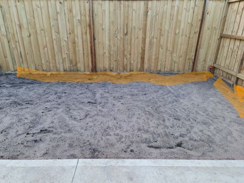

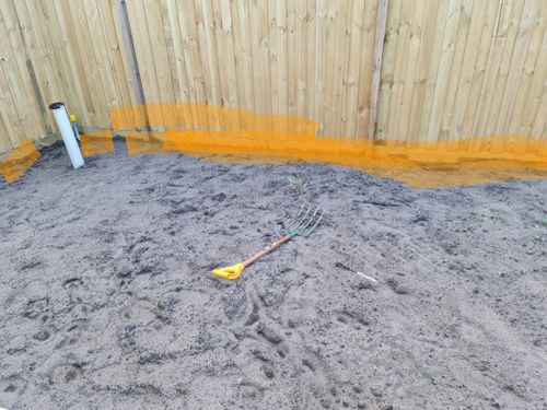

This would be my first post here, I would like to get some suggestions if I am going in right direction. I am trying to level the backyard which is approx 12 x 4 meter , I have got top soil and started to level but I am worried because of the fencing, If I push the topsoil towards the fencing will it cause any concerns with the fence in future.
Please let me know if there any other way we can get this sorted out. I have attached some pictures for reference.

Welcome to the Bunnings Workshop community @rakeshghandham. It's a pleasure to have you join us, and many thanks for the question about levelling your backyard.
How high do you need to fill against the fence to level the yard? You've got two types of treated timber there. H3 timber for the pailing, which shouldn't have soil placed against it, and H4 timber for the horizontal sleeper underneath the pailing. I've added an image below to illustrate. You will be fine filling the soil up to the top of the sleeper at the green line, which won't cause any concerns. If you need to fill higher, we'll need to come up with a solution to hold the soil off the fence and pailings. Bear in mind if you're laying turf, it itself will be about 40mm thick, so take that into account.
Thanks for your quick response @MitchellMc , appreciate it.
yes will consider the 40mm for the turf and will put the soil on pailings.

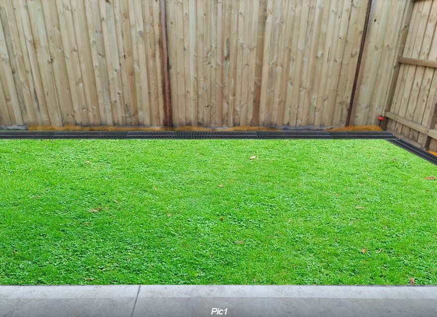

Hello @rakeshghandham
Just to add to @MitchellMc's great advice, I recommend putting some Everhard EasyDRAIN Polymer Grate & 3m Prejoined Channel to protect your fence. Any water that comes around will be caught by the drain and redirected out. I've placed a virtual layout for you at the bottom of this post. Have a look and tell us what you think.
Please keep us updated, we look forward to seeing your newly laid turf.
