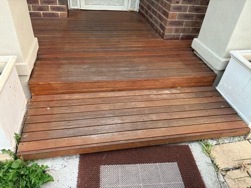

I replaced my 23-year-old, 12m deck with new marabou slates in June 2023, and then in October 2023, I treated them with Cabots Merbau Aquadeck Exterior Decking oil. Throughout the process, I was continuously getting advice from the experts at Bunnings.

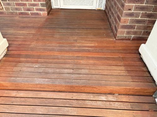

Now, I feel it’s time to give the deck a bit of a refresh, especially since the heavy traffic areas have gotten quite dirty. I’ve attached some current photos for you to take a look at. Could you please let me know what steps I should take now and what materials would be best to make the deck look brilliant again?
Thanks so much!
Syed
Hi Syed (@smhasnain),
While your deck still looks great, it looks like it's time for a maintenance coat of oil to have it looking brand new.
Start by giving your deck a good clean with Cabot's Deck Clean and a Long Handle Deck Scrub Brush. Check out How To Clean a Deck for some guidance.
Once clean, the process is much the same as what you did initially. Apply 1-2 coats of the Cabot's Merbau Aquadeck Exterior Decking Oil with an oil applicator and a paint brush. Check out How To Oil Your Deck for guidance on this process.
Let us know how you go and if you have any questions along the way, please don't hesitate to reach out.

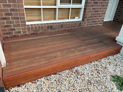

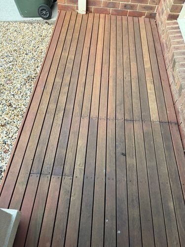

I have cleaned the deck and attached some images for your reference. I’ve noticed that certain areas of the boards appear to have darker, more brownish patches compared to the rest of the surface. I would appreciate your advice on how to address this inconsistency in colour. Should I scrub these areas further or consider using sandpaper to achieve a more uniform appearance?
Additionally, I have a few other questions:
I would greatly appreciate your expert advice on the above points. Thanks
Hello @smhasnain
In its current condition if you were to oil it now, there is the possibility that some sections will be darker than others due to the stain of the old oil still on the surface. It's also possible that some sections will not absorb the oil properly because there are still sections of your deck that are sealed with the old oil. In order to get a uniform finish, I suggest sanding the entire surface back to wood. This will remove all the unevenness of the surface and bring you back to the original surface of the wood.
Once the decking panels have been sanded and cleaned properly, you can then make your plans on staining its surface. Please do not mix stains as they are not compatible with each other and will produce an unreliable finish. I suggest using only one product for your entire deck, I recommend visiting your local store and looking at the oil and stain sample board in the paint department so that you'll have a better idea of what the finish colour will look like.

I recently purchased brand-new Aquadeck Merbau and applied two coats on my deck after using grate 240.
However, I am not entirely satisfied with the outcome.
Could you please review the appearance of the deck after the two coats, and compare it with the previously submitted photos taken after the pressure wash but before coating?
I would also appreciate any suggestions on how I might further enhance the sharpness and overall appearance of the deck.
Thank you very much for your assistance
Hello @smhasnain
Thank you very much for sharing those pictures of your newly revamped deck. Looking at your first pictures and these new ones, your deck freshly sealed deck looks much better. I suggest putting on an extra coat to make it a bit darker.
