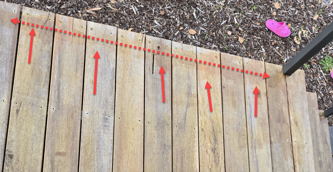

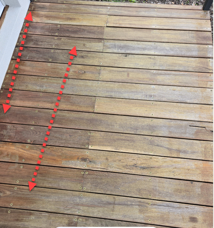

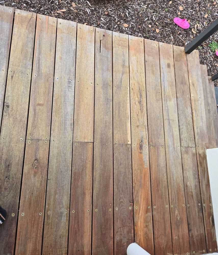

Thanks Jacob. I did sand with a 120 grit. See attached pic. Does the sanding look ok?
Hi @MSD,
It doesn't look too bad, but I can see some patchiness that could show through once oil is applied.
I'd suggest giving these sections another light sand to even things out a bit before applying your coat of oil.
Thanks Jacob. Is it better to go to a 80 grit and then to a 120? Or do i just use 120 to remove the patchiness
Jacob, i am having struggling to get rid of the patches on the deck with the ozito detailed sander I have.
I went to bunnings yesterday and they recommended the 18V Cordless Ryobi Belt Sander that I purchased.
Haven't use the belt sander previously and read that it is pretty powerful piece of equipment.
Any tips on how to use it without damaging the deck?
Should I consider buying another sander such as thw random orbital?
Mitesh
Hi @MSD,
I wouldn't suggest using the belt sander on your deck as it doesn't need resurfacing. There are just some areas that look like the previous coating wasn't applied evenly. You could change to 80-grit in your detail sander, but I wouldn't push hard as you could scratch the timber. A belt sander is really a bit aggressive, and you risk damaging the timber.
I would scrub the deck down with Cabot's deck clean and see if it minimises the blotchy areas. If you were happy with the look of the deck before, then you've now improved it by sanding the areas. Give it a good scrub and you might like to post some images to check with us before coating.
