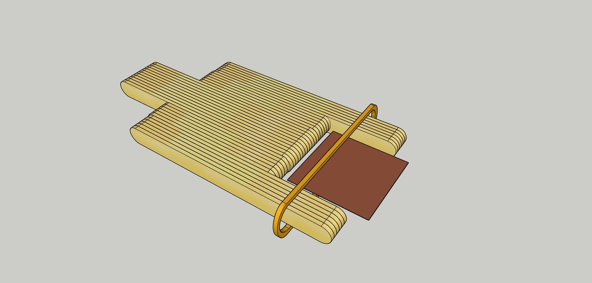

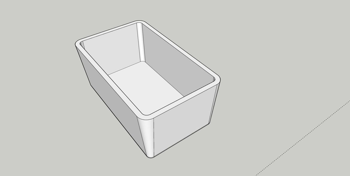

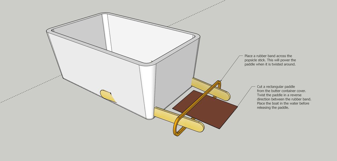

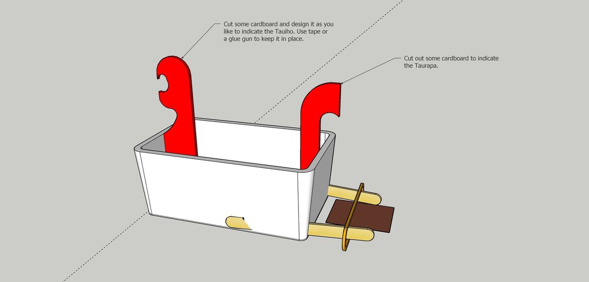

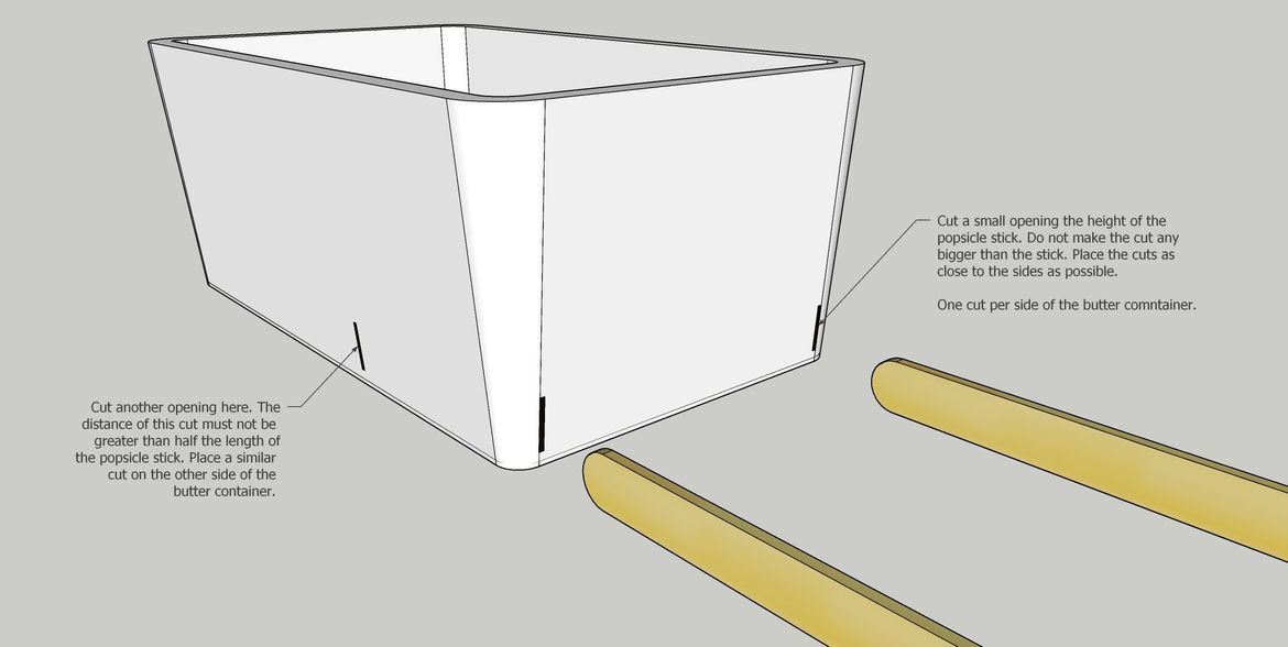

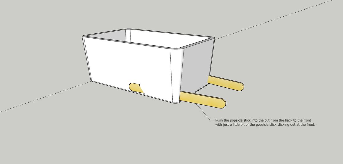

Below are the instructions to build the waka. Basically, it is a small butter container with a paddlewheel at the back that will make it go forward. You can use PVA glue to stick paper on the sides so that the children can design their boats. The other method for older kids is to assemble popsicle sticks and glue them together in the shape of a boat with the same rubber band paddle pusher. You will need a large tub or a kiddie pool with some water so that the children can float and run their waka in the ocean. Always have extra butter containers just in case some of the children forget to bring their own.
Materials:
The assembly instructions are indicated on each picture. If you have any questions about the assembly, please let us know.
