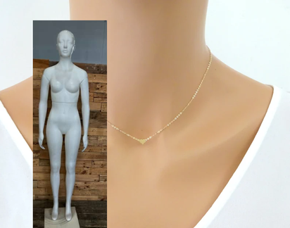

So my brother is setting up an accessories business and he need a brown skin color mannequin to display his accessories
Problem is mannequins in Australia are all imported from overseas and because of their sizes, the shipping cost alone can be massive for at least $200 , not to mention the item cost
And we have found a second hand one, sold for $30, but the color isn't the one he needs: brown light, like human skin color
Then we see some people actually "paint" these dolls to change their colors , and an online guide for this:

The challenges we are having:
1) Is it possible to achieve this with supplies from Bunnings, to change this doll to the light brown colour shown in the above pic? which one should we get: Dulux Duramax , Rust-oleum 2X Ultra Cover Paint+Primer, Dy-Mark Acrylic Spray Paint ?
2) We only have this sample photo which shows the exact light brown colour we want, how can we Bring this sample to the paint counter for a colour paint match??
Wholehearted thanks for any thought to deal with this special challenge😆
Hi @ivanptr,
I've looked at the instructions, and they suggest you'll need the Dulux Duramax Plastic Primer. This is a plastic-specific primer that allows your topcoat colour to adhere.
You'll also need a topcoat in the skin tone colour of your choice. The Dy-Mark Acrylic won't be suitable as it only comes in bright colours like red, green and purple. So, that leaves you with the Rustoleum 2x range. Unfortunately, there are no skin tones in that range either.
The issue we're faced with is that no skin-coloured paints are designed to go over a plastic or plastic primer. You could do a test section to see if Dulux 300g Metalshield Epoxy Enamel Gloss Spray Paint Classic Cream or White Knight Touch Up 300g Paperbark Spray Paint adhere sufficiently over the Duramax plastic primer. They are about as close to the colour you're looking for as I can find. Still quite far off, though.
The other alternative is to do away with the sprays and use brushable products like Dulux Maximum Adhesion Primer. Once you've applied this primer, you'll be able to have a can of paint mixed up in a colour close to what you're after. There are hundreds of skin tone colours to choose from and have mixed up.

What if we go to officework to print the sample photo and ask the paint counter to do a color match (mixing colour tints) to:
Hello @ivanptr
The Dulux Maximum Adhesion Primer is not made to be used as a top coat. Its purpose is to go on the plastic surface of the mannequin which will then allow you to paint over its surface with ordinary interior paint in any skin tone you want.
In order to get a flawless finish with no brush strokes noticeable, I suggest investing in a paint sprayer, this will allow you to spray the primer on and the top coat as well. The best part is that you can repeat the process over any type of mannequin except those that are wrapped in cloth.
