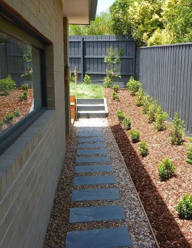

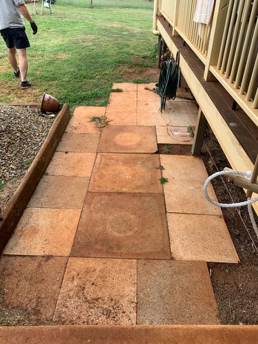

Hi all,
After 20+ years not knowing how to solve this issue and living on a farm with unlevel ground I wish build up gravel and pave up to metal house posts. Our place is subject to paddock runoff from contour banks and I am terrified of white ants etc so I don’t know how or what kind of barrier I can use. It’s better if I show you photos of what I would like (not my image) Vs existing old pavers. Apologies if I have not explained myself very well as it is my first post. Confused Bunnings shopper! Samantha

Can you please confirm that the top photo is some inspiration of what you would like to achieve and the bottom photo is your house?

Thanks Jason. Yes the top photo is something I have in mind and bottom photo is the back of our place. I don’t want to screw anything to the metal house posts and am reluctant to place sleepers against those posts. We have a concrete carport which we would like to build up level with (Approximately 150mm high) in places so was thinking some kind of retaining wall but not directly against house posts. Thank you for responding.

You might like to look at our range of concrete sleepers. They'd hold back your gravel without encouraging white ants. I wouldn't have thought gravel to be a medium that would overly encourage white ants. Normally, timber sleepers, bark and organic material need to be held back from dwellings in white ant prone areas.
There are also preventative products like David Grays 500ml Ant and Termite Spray which can be applied around your home's perimeter to discourage white ants.
