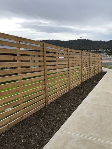

I have a new built slate fence, but feel like the gaps are too wide between slates and make me concern about privacy.
Is there a way to easy fix and reduce the spacings between slates?
(mine is similar to this fence)

I don't recommend disassembling your fence to change the gap between the panels as this might damage them while being taken apart and repositioned. The gap would have to be very small to interfere with seeing through the fence. One way to prevent people from seeing through the fence is to add more panels on the other side to cover the viewing gap.
Another method is to install Coolaroo 1.83m Wide 70% UV Light duty Shade Cloth per Metre between posts on the inside of the fence. This will block anyone from seeing in but still allow the wind and rain to pass through. It also provides a nice cover for your fence from the inside.
