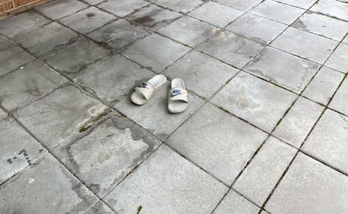

Hi
I’m looking for advice on how we can revamp our outdoor patio area. It’s currently tiled (see photo). Looking for advice on the best way to clean these tiles so they are back to being close to perfect again (tried high pressure with a few products that don’t seem to work). Open to paint or render ideas too.
thanks
Re: How to refresh tiles on my outdoor patio area?
Welcome to the Bunnings Workshop community @JPupulkovski. It's sensational to have you join us, and many thanks for your question about restoring paving.
It looks like there is significant staining to the pavers, and it is unlikely that you'll get a perfect result through cleaning. I'd suggest the easiest way to achieve a desirable finish would be to coat them with paving paint. Have a look at this helpful step-by-step guide: How to paint a concrete floor. The process will be very similar to your pavers.
Make sure to remove all that organic material between the pavers with your high-pressure washer before prepping the surface for paint.
I look forward to seeing your results, and please let me know if you have further questions.
