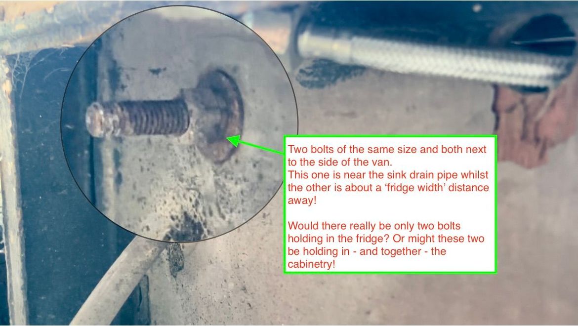

But I did discover this:
As it says, only two bolts, both next to the side of the van, and what I'm guessing from underneath the van is about the width of the fridge apart from each other.
Now, I could undo those bolts and see what happens, but if they're holding the cabinetry in, or worse, together, I don't want to be mucking around with that. I don't want to get myself into more trouble than I know how to get out of.
Thoughts, anyone?

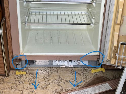

"Locked in place" via imprint into lino. If you go searching for the query I posted you will come across tint fridges that dont have wind up feet, they have a "bump" at the front and smooth at the back. I figure its to help the door stay closed. The imprint I am refering to is you know when ther is long term weight on lino and you move it, there is a divit left behind. I am suggesting that the fridge might be resting with its front bumps (feet) in its own self made divit.
The blue circles are where I am suggesting to put those clamps, that panel between the blue wonky circles looks loose?
The yellow lines are for the "bumps" causing impressions into the lino that would make movement harder.
The blue arrows are the horizontal pull from the bottom towards you.
If that panel isnt loose and cant be unscrewed then that hole on the left, on that control plate looks like you could slip a clamp into it and pull toward you.
I saw the bolt photos when you answered @Nailbag, not sure what they are for but maybe have a search for caravan construction methods form the 1950's? As in build diagrams. (not sure of the era of your caravan but methods will stay the same ish) I dont think they will be fastened to the fridge, mostly because it would take two people effort to line it up and install it (it dosnt have a logic sequence for building)

The ‘hole’ on the bottom panel, to the left of the maker’s plate is not a hole, unfortunately. It is very deceptive! It’s a small window which, I think, is where you can check that the pilot light is on.
I will keep searching and I am now interested in knowing what those two bolts really are for. I shall keep you posted.

Personally I would have a go at @Dave-1 suggestion and/or removing those two nuts. I would have confidence that nothing like the cabinets will be effected especially while the van is no in transport.
