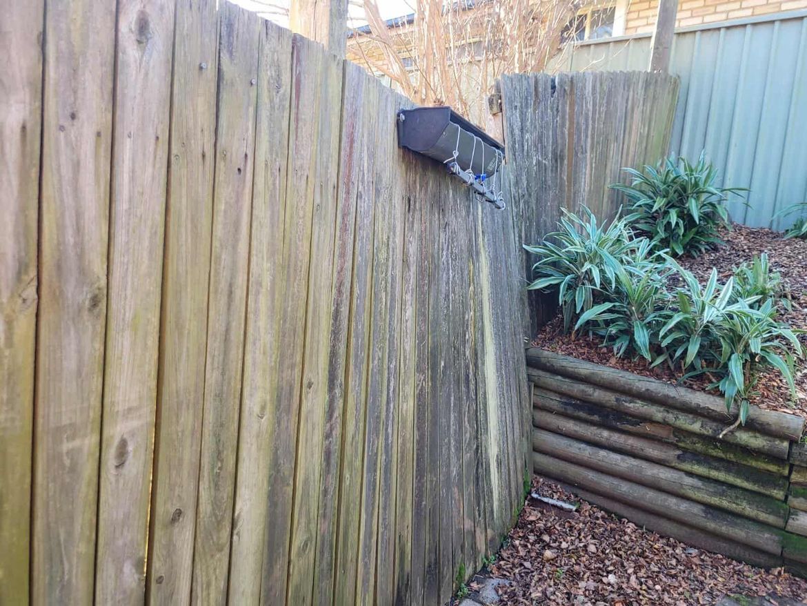

I came to inspect it today and looking to remove old retaining wall timber and extend the courtyard (will be looking to remove and relay pavers). Also looking to remove clothesline from middle and moving it somewhere else (I'm reaching out to strata to put a new fence dividing the two properties as that is also timber fence that is leaning.

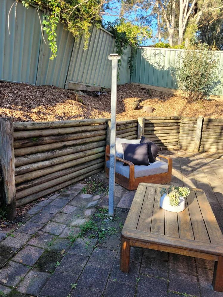

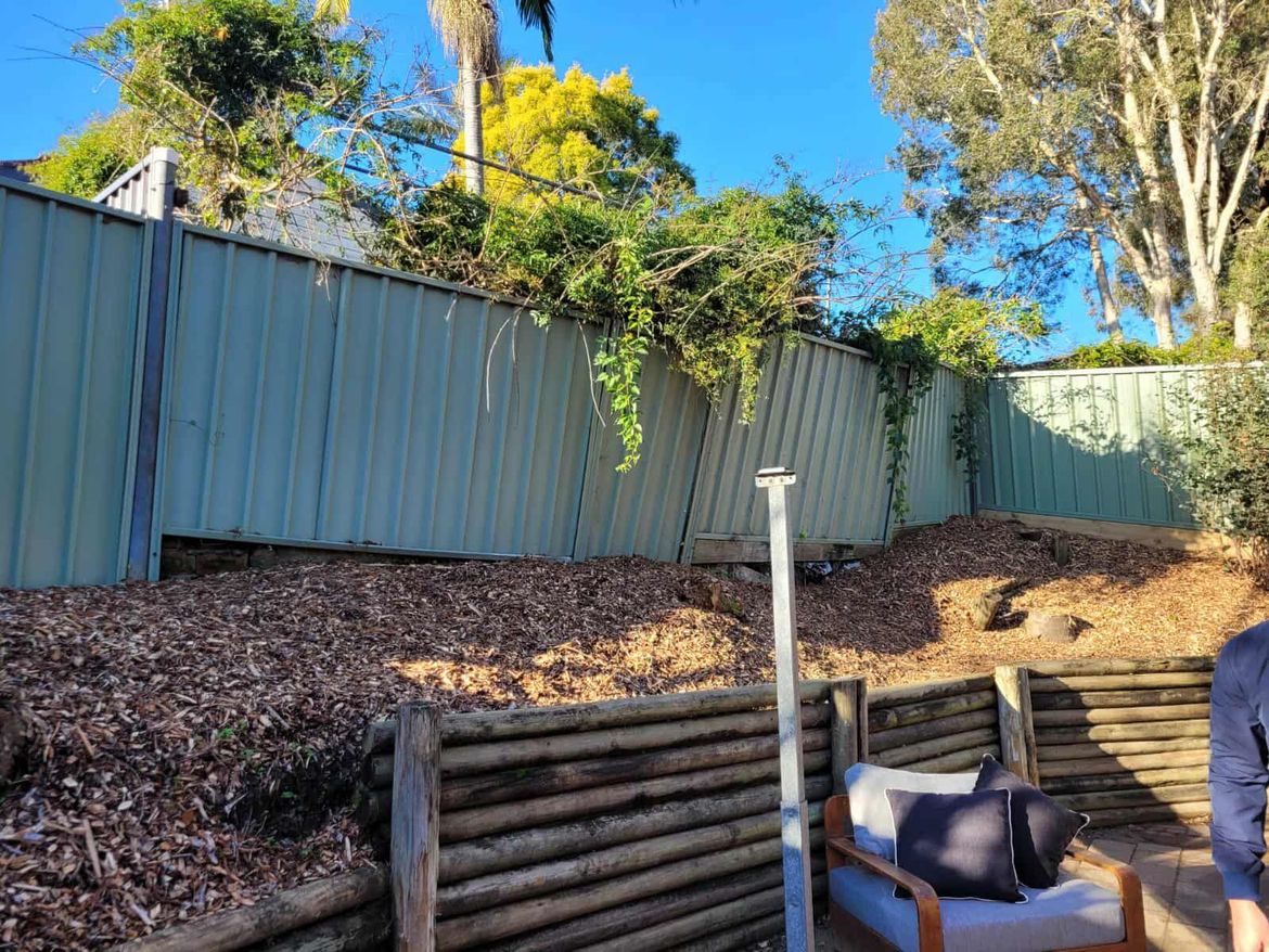

There are huge tree trunks and roots that you can see on the wall and the roots run on the pavered area (some pavers are lifted).
The backyard neighbour also has the fence leaning (again strata issue...).

Dividing Fence (clotheslien attached
See backyard neighbour's fence leaning..

The old leaning treated pine pole wall is retaining substaintial ground, which is giving way in the corner which has impacted the rear boundary fence. above. This is definitely not a straight forward DIY project. The easiest method is to build a new wall in front of the existing, using galvanised posts and 75mm thick TP sleepers. In order to provide additional strength, I would angle the wall a few degrees back off plumb to add additional strength, which is a common design aspect with this type of retain.
Due to its height, the posts are going to be significantly deep into the ground, and that alone is going to be a major challenge without using a powered post holder digger and the back of a machine.
If you really want to move it back, then it's going to get very complicated as there will be no way to retain the soil without some very clever and expensive engineering. And thats not a DIY project.

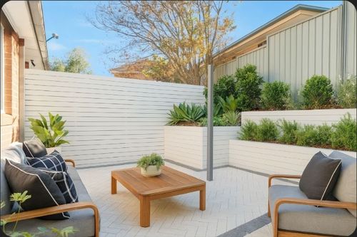

I have put out quotes for below but my uncle who does and did a few of these said I should do it D.I.Y lol. He sent me an inspiration photo. I am just worried about collapsing my neighbors fence if I take out the existing timber wall (I'm hoping the neighbours fence is atop of an existing brick wall)
