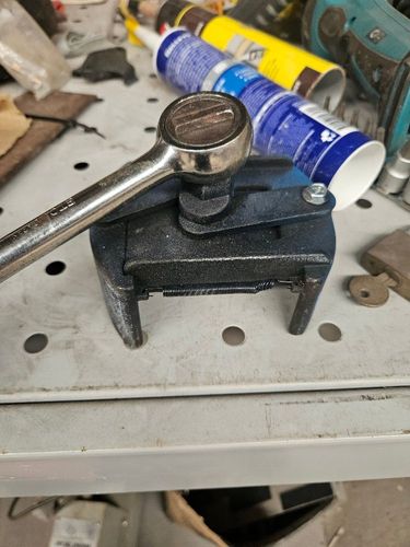

im the same down pipes connected to tank and need access the PVC caps so i can clean the pipes each year. i found this tool in picture. opens up and clamps onto the plastic cap.the racket makes the jaws bite in allowing you to undo and remove the Cap
Re: How to remove stuck Holman stormwater cap?
Hello @jimtom1
Welcome to the Bunnings Workshop community. It's wonderful to have you join us.
Thanks for sharing your knowledge and experience with the community. Let me tag @Tony11 to make them aware of your recommendation. If I'm not mistaken that is a self-adjusting oil filter removal tool. But I suspect it will work just as well in removing PVC endcaps.
