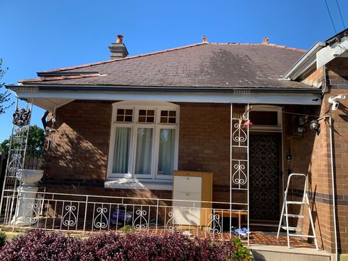

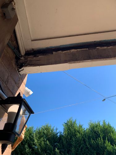

We have a front beam on our property that has developed rot along approximately the last 15 cm at one end. The rest of the beam—spanning around 5 to 6 metres—appears to be in good condition. Fortunately, the beam is already well supported by metal pillars positioned in the middle.

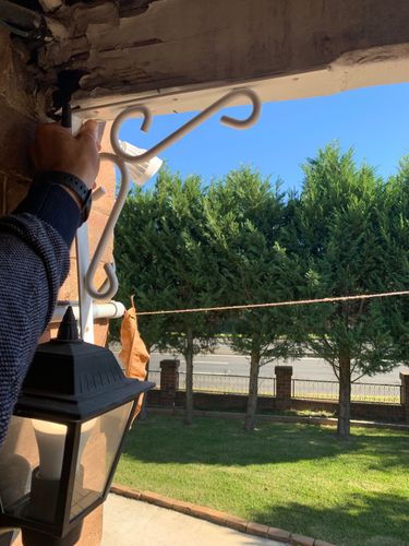

To reinforce the affected area, we’re considering installing a metal bracket (as shown in the attached figure) to provide extra support and prevent further deterioration or structural risk. We’ve explored the option of replacing the entire beam, but this would be a costly undertaking. It would require roof scaffolding and extensive work for what seems to be a relatively localised issue.

The damage appears to be semi extensive as one end appears to have rotted, and the rainwater appears to have travelled inside and has rotted the top section of the beam.
I propose taking that next step and getting a quote from three different builders and see which one offers the best possible value for the money. Placing the bracket is mostly a band aid solution, it will not offer a long term- fix and the rot and damage will continue to creep along the entire beam.

The issue appears to be resonably large. Its not just a matter of a bracket supporting the end of the beam (The rot has weakend that whole end of the beam so supporting it really wont be an answer) The beam looks like it goes into the brickwork and sits there supported by the wall. This would also stop forward movent of the weight of those tiles towards the front of the yard by locking the roof into place.
I would also recommend to get a few builders quotes to replace and fix the water issue that has caused teh timber to rot in the first place. The roof will need ag prop supports while you repair the issue. It may also be an idea to investigate the eves around the location as well. Mostly due to the age of the property and if there is one section rotting it doisnt hurt to check others.

This is a common issue I deal with regularly. The extent of the rotted end is fairly large and on the board of a full replacement. However a new section can be "spliced" in after the rotted section has been completely removed.
Both @Dave-1 and @EricL advice on getting a few quotes from builders though is sound, in reality the job is to small for them. A decent handyman service can do the repair. And again get a couple of quotes and check reviews and compare their method of repair. If in doubt, should that info our way for review.
