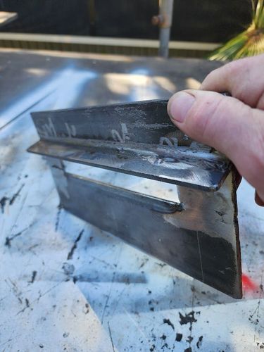

The front with the letter opening 'awning.'
On the inside, is the letter 'slippery dip.'
Dunno if it's necessary, but it should prevent letter corners getting caught in the rebated area. This is 'C' - 227 mm.
Still got some fine finishing to do.
Cheers.

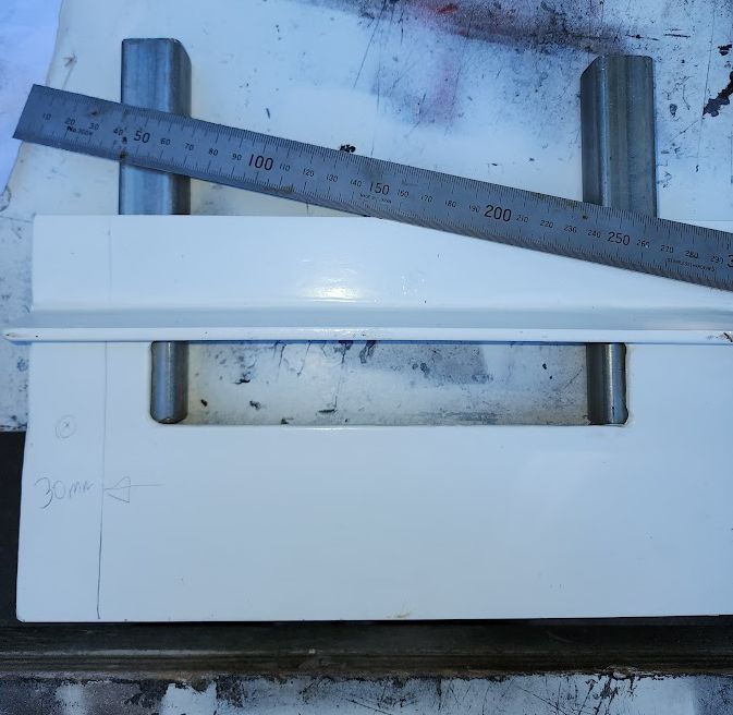

Hi @Noyade. Ive been and checked my letterbox.
I really love your original idea but see the challenges you have highlighted.  My original opening was somewhere around 185/190 before being stolen.
I think full hog of 227 for the mail opening probably won't be the best as the internal size is 191 so mail would potentially be pushing up against the uprights at the external edges and maybe getting stuck or damaged.  Also the top section of the letter box uprights (30mm ones) has been mostly ripped away when it was stolen so I would be concerned about having something substantial to anchor it to at the top if done in 2 sections.  I hope this makes sense.
I had this thought, not sure if its doable or a good idea...can I 25x25 square be in 2 parts each side?  A small section which is from the top stopping just above the mail opening, then a large section that is just below the mail opening to the bottom?  So in theory no 25x25 at the opening so it can be made the width of 190?

No, it's all good mate - easy fix. Tomorrow I'll cut back that internal lip to fit the gal square.
Just be aware you will then have only a 174 mm width for your letters.

Morning @Melway7
"I think I prefer the wider opening"
I had the angle grinder poised to cut - then thought I'd better look at the Workshop first for updates. 😁
Below shows how the square tube reduces the width to accommodate the rebate. I think if we were neighbours we could easily sort it out, but if I weld them a millimetre or two in the wrong position - you may have to cold chisel some areas or use excessive amounts of glue. Shown also is the 30 mm edge. I was thinking of drilling holes for screws - but probably better to see how the liquid nails goes.
You owe me nothing, as discussed. This is to deter dementia - keep moving, keep thinking and keep tinkering.
