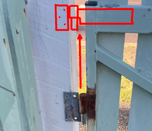

We just bought our first home and my first project is to fix the gate to the driveway.
The hinges are rusted and poorly fixed to the posts, the gates require lifting to open as a result.
I don’t have a welder, just a drill. What is the best way to repair or replace these hinges?

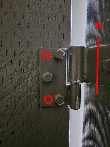

They look to be these hinges?
They have cut at 'A' and welded.
Installed so far from the post they gave up on the inner pre-drilled holes and made two extras at the left.
And so close - they had to angle the screws to the left.
"I don’t have a welder, just a drill."
Fair enough - but I would be looking at an inexpensive angle grinder to add to your new home arsenal.
I would consider - repurchasing/replacing/moving the top hinge higher utilising the full length of the arm, allowing to grab more steel with Tek screws (welding would be better) and post wise, going with Hex-head coach screws.

I had not taken the gates off the hinges, but I managed to do that, and got the remaining screws out!
Some with more wd40 and muscle, and for two I drilled the heads off using a cobalt drill bit.
I haven’t lined them up to measure the gap, but the opening is 3050mm and the gates are 1465mm each.
@AlanM52 so will I add extra wood to the right side now?
@Noyade if I use a different hinge at the top, can I just leave the old one attached? Is this the right hinge:
