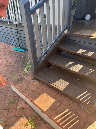

Hi all,
Any suggestions on how to remove this post and replace it?
Do you think the post is rooted into the cement? so I will need to use a demolition hammar to get it out?
1) demolition hammar to break up the cement
2) remove post
3) put new post in
4) patch up with cement
And what about the slanted timber piece right behind the post, is that rooted in the cement as well? or is it just sitting on top of of the cement?

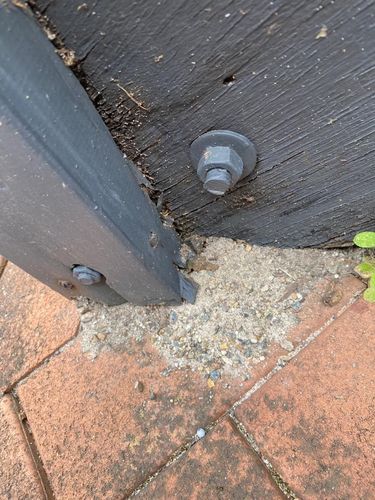

footing for the post.
this is the footing for the post.

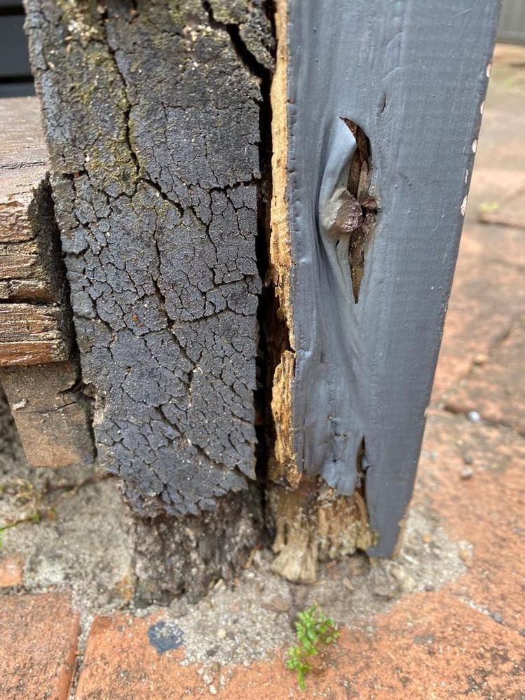

close up of the footing

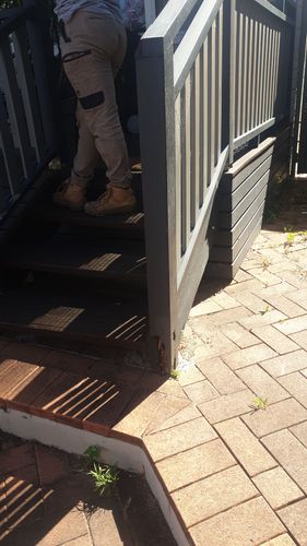

this is the left footing with some context of the steps
Hi @Quachy
Good move on spotting that Post it looks good and ready to fail and those steps are a little on the ready to fall apart side too
As a project can I suggest a new set of three step stringers not just a post. Either timber or steel that simply rest on the ground on top of your pavers (dig out old post 100 mm deep only is ok and fill with cement with a cut to size paver cap. Steel and treated pine options at Bunnings web site type in search (stringer 3) for options.
Your hand rails look ok you could recycle them just replace front post and attach to new stringer set.
See what you think as a starter guide.
https://www.bunnings.com.au/stringer-h3-treated-pine-suits-3-tread_p0052935
Welcome to the Bunnings Workshop community @Quachy. It's brilliant to have you join us, and many thanks for your question about repairing balustrading.
It's a bit hard to tell from your photos if the post is concreted. The stair stringer (slanted timber piece) wouldn't be, though. You'll soon find out if you dust away that sand and remove a brick.
If there is a solid concrete footer there, you'd likely be able to get away with Dynabolting a bolt-down or T-blade post support. That would save you from having to dig out the footer.
If you are going to the extent of replacing the posts and stringers, then I'd suggest you do the whole lot and replace the treads too. That bottom one especially doesn't look like it's long for this world.
Please let us know if you have further questions.

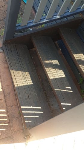

I've just noticed the white section under the bricks in your last image. Is this a concrete pad?
Hi Mitchel,
will the process steps change if it is a concrete pad? That's what I think it is, because there's bricks around it and then cement there. I'm heading over today so will be able to get a better look to start inital work
Hi @Quachy
It's difficult to tell until you have the entire thing taken off, there might be a T blade already installed between the post and the stringer. However, if the timber is sunk into the concrete footing, it's going to have to come out if it has started to rot as well. Ideally, the old timber has to be taken out and the gap filled with concrete. When that cures you can then install a galvanized post support for the new post and stringer set.
