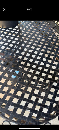

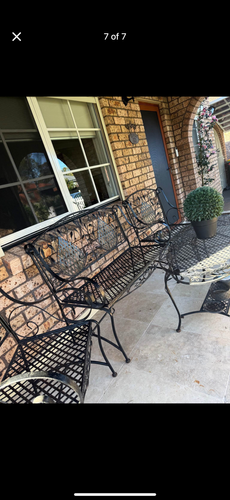

I have an outdoor furniture metal/ iron set that is getting rusted and in need of some TLC. Any advice on how Incan restore this and what do do to bring it back to life.

The general steps are to sand the surface, treat the rusty spots, prime the surface and then put the top coat on. I recommend using the White Knight Rust Guard Paint System. It is a complete paint revamp set that includes rust converter, etch primer and topcoat.
Here is a handy step-by-step guide: How to Paint Metal
Please remember to wear personal protection such as gloves, goggles and a mask when working on your restoration project.
