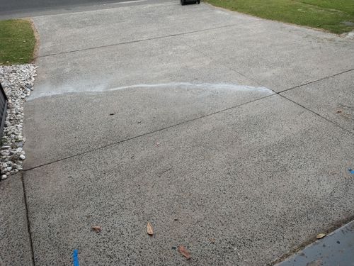

Pics of drive attached. Rough aggregate about 30 yrs old. In sound shape except for a crack only a few mils wide. I have repaired this with Earl's as per a Bunnings forum post.
I have cleaned with chlorine and pressure washed it.
I have not considered painting as yet because we wanted to paint the garage but got mixed messages about what type and longevity.

I can see the rough aggregate in your photos @alwaysasking. That texture is going to be tricky to smooth out. Painting, unfortunately, won’t give you a smooth surface; it’ll just coat the existing texture.
I understand why you’re considering resurfacing, as that’s really the only way to achieve a smooth finish. You could attempt it yourself if you carefully follow the product instructions, but achieving a truly smooth surface requires some skill with troweling. This is where a tradesperson can be really helpful. They’ll have the larger floats and trowels needed to level and smooth the area properly. As a D.I.Y. project, you might find it challenging, especially across a large driveway, to get a consistent, smooth finish.
I'd recommend getting a few quotes to gauge the cost of a professional finish.

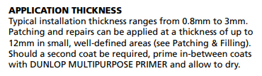

I'm afraid the Dunlop Concrete Resurfacer Mortar is not applicable for your project. As stated in the data sheet, typical installation thickness is anywhere between .08 and 3mm. It will therefore not be strong enough for vehicular traffic.
