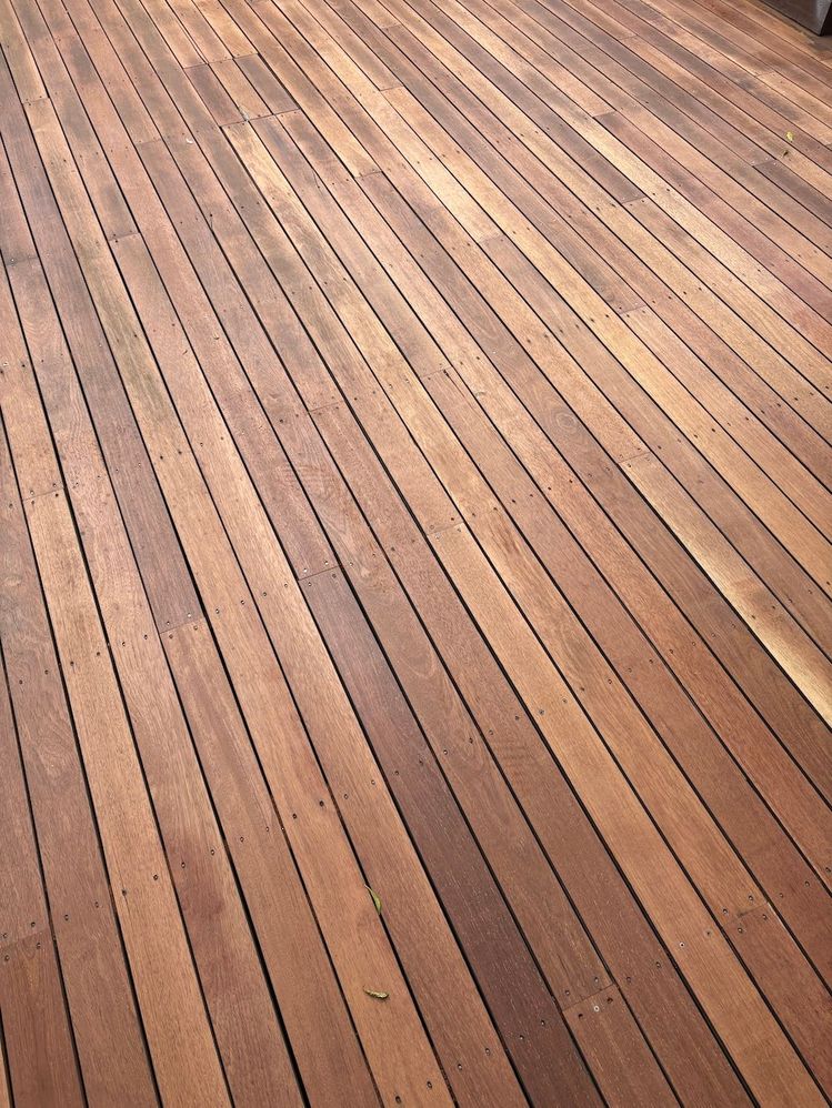

The deck has been sanded back and looks great. Thanks for all your suggestions, I've attached images for reference (I still need to do the edges).
Next step: Oiling the deck. I'm a bit confused if I need to use Tannin & Oil Remover, or if I can just start oiling the deck first?
My goal is the have the most natural, transparent oil I can get and reduce darkening it as much as possible. Please let me know thoughts - I was using this guide here as a reference
I also noticed since sanding it back (Started with 40 Grit and then smoothed with 120 grit), that literally EVERYTHING marks the wood. Even the slightest speck of rain ends up marking the wood - is this normal? To counter this until I coat it, I've covered the deck with Tarp.
What will remove any of these marks before I start to Oil the deck?
In Summary:
- Do I need to use Tannin & Oil remover?
- Which products provide the clearest/most transparent decking oil?
- Is there any way to remove stains/rain marks on the deck before oiling which happened between the sanding and oiling process.

Good Morning @bodega
Thats some nice work :smile:
Yeah rain will mark it until you seal it, its really pretty much raw timber until you stain it so I would maybe cover it until you do with a tarp or painters plastic as a precaution.
When I sanded my deck with a belt sander because I had high screws, I didnt clean the area before sealing. I swept it smooth and dust free tho.
So when I oiled the deck the next day it looked great, and it rained and still looked great. within a week tho I had a bunch of tiny little plack dots appear all over the deck and more spots in certain areas. I was confused as was the crew about how and what happened. Eventually I think it was @he local Bunnings guy from Kembla grange suggested that the oil may have reacted with the metal fragments from when I sanded the deck and then the rain caused a type of bloom/reaction with them and the oil. (he was right :smile: )
I decided to leave it as no way I was going to redo the lot lol there was also a suggestion that it would fade with time from someone. This turned out to be true thankfully :smile:
So I would wait to have it confirmed but washing the deck and scrubbing with a deck cleaner would be a wise move and letting it dry totally before you seal it would be the way to go. I will let @EricL and @JacobZ  suggest the best type of deck cleaner tho. (yeah prob @Nailbag knows as well :bigsmile:
Here is a link to the hardwood deck restoration Hardwood deck restoration where you can see the black dot bloom I am refering to.

Hello @bodega
Thank you very much for the update, the deck sanding turned up superb. I suggest using Cabot's 1L Deck Clean - 1L to give it one last wash before you begin oiling the surface. It's great that you've received excellent advice from @Dave-1. I propose looking at either the Intergrain 10L Natural UltraDeck Timber Decking Oil or the Cabot's 10L Aquadeck Natural Exterior Decking Oil
Please note that timber surfaces will tend to change when a wet medium is introduced to its surface. It's just like when raw timber gets exposed to rainwater it goes a bit dark. I suggest testing the oil in a section of the deck where it is not immediately seen. Give it a day or two to settle on the raw surface and see if you like the finish. If you are happy with the results, then you can commit the entire deck to the oil you've chosen.
In order to gather more information, I suggest visiting your local store and having a look at the timber oil sample board. There you will see how the oil reacts with different types of timber and see what they actually look like. Remember to speak to the paint specialist to gather more insight about your goal of getting a natural transparent look.
In regards to the stain marks, they will all fade away once you've given the surface a final wash. My best advice is to look at the weather for the week to make sure that you have several days of sunshine in a row so that your freshly oiled surface does not get rained on.

This is looking sensational @bodega
I've just finished reconditioning/oiling 7 decks in as many weeks and I wish they were as prepared as yours.
My recommendations for next steps are:
1. Use a deck wash to rinse any contaminants off. I would do this late afternoon, then broom the excess water off when done. This will mean that as early as possible the next morn ing it will be dry to oil. Plus I use a long handled tin opener to flick out stones etc stuck in between boards.
2. I've used all the major oil brands, and by far Feast Watson "matt" finish is my go to. Not only does it dry faster than the others, it never leaves a tacky residue that can last several weeks. They do have a standard satin finish, but I've not used this so, I can't say on how it dries. Oh and its mid-price point to which is another plus.
3. If the deck gets mostly sun, I would do 3 coats otherwise two. First coat will always take 2-3 times longer than subsequent ones. Start by cutting in all the edges, sides and any steps with a fine haired fence brush. Then I like to use this type of brush for the oil.
4. Diarise for November 2026 to re-oil two coat if lots of sun or you might get away with one coat if mostly under shade. And I always desk wash first after my pressure washer which I use to remove debris build up at joist points.
