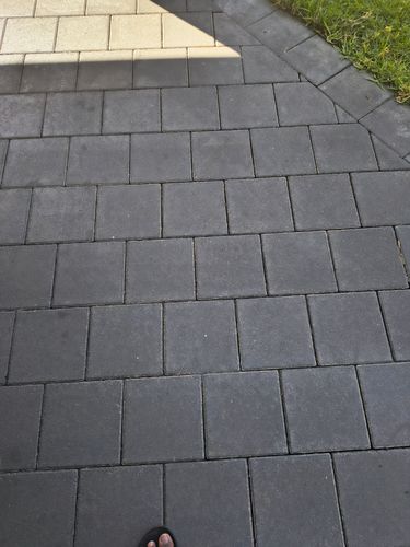

1000063908.jpgMy patio pavers got marks from pressure washing and would like to restore back. Just a sealant will fix it back or should i use some kind of painting ? Appreciate if you can advice me.

It appears that the pressure washer was run over the surface in a random pattern. In order to uniformly wash the surface, I suggest using a patio or surface cleaning attachment on your pressure washer. I recommend running the surface cleaner in a uniform left to right fashion as you move forward. The surface cleaning attachment has been designed to spread the pressure evenly to prevent the line cleaning phenomena you see on your pavers. There is no need to use chemicals, you just need to wash the surface once more in a uniform pattern and avoid going in random directions.

I thought I'd add that if you are then able to clean the surface and remove the lines, you can then seal the pavers with Crommelin 4L Water Based Paving Sealer. However, if you can't remove those lines, then you could consider painting the surface with Dulux concrete and paving paint. Here's a helpful guide: How to paint concrete floors.
Sealing alone might not correct the marks, so it's best to do a test section in an inconspicuous location first.

After using a pressure washer drum all the lines are gone :smile: planning to seal it off in couple of days.
