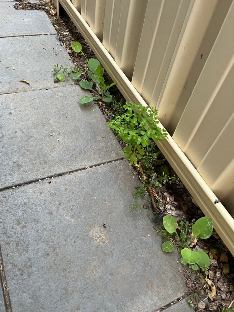

There is a small gap between the bottom of my Colourbond fence and the ground which allows all the leaves from my neighbours hedge to enter my property. It’s frustrating and I would like to know how to block this gap?
Also, the ground under the fence is soil and weeds grow there. How can I stop this weed growth? Perhaps matting or small rocks?

I'd suggest using 150 x 25mm 4.8m Plinth H4 Treated Pine Sawn Wet and screwing it to the posts at either end of the space with self-tapping screws. Alternatively, you could place timber stakes in the ground and screw the board to those. The team in-store can cut the timber down to the required length for you.
For the weed issue, I'd suggest removing 5cm of that mulch, placing down weed matting and filling over it with pebbles or mulch.
