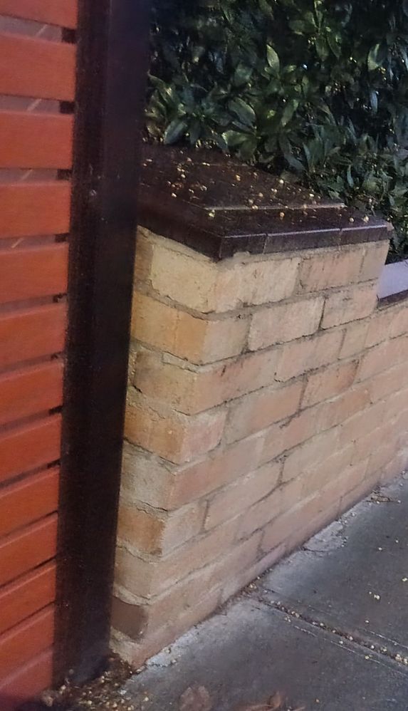

Thanks Jacob and @AlanM52 In the image three holes are seen on the wooden post where the screws have been anchored to the brick pier.Wooden post.jpg

Hi @rraus,
Yeah, that certainly doesn't look ideal.
Any lateral loads applied to the fence from impacts or wind will be relying on three small bolts into an already leaning brick pier.
As the fence appears to be incomplete, I would suggest it is disconnected from the pier and concreted in as all other posts should be.

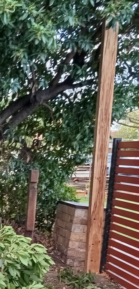

Hi @rraus,
@JacobZ RE: Yeah, that certainly doesn't look ideal.
Looking at that all the angles scrambled my brain.
That 'fence post' is more like a structural beam.
I thought that brick pier was a mailbox.
Sorry to ask again and I think it's important... more photos from further back and from the other end of the fence line.

Hi @rraus
Having read your description of the fence post, I suggest either digging into the ground and installing it with a concrete footing or rebuilding the brick pier and anchoring onto it once it is properly reconstructed.
