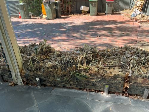

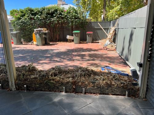

Looking for any ideas to stop leaves coming through the gaps in my glass pool fence! Ideally something transparent so it’s not obvious.
My undercover pool is situated lower than my driveway (that has planters along it) so leaves and dust blow off the driveway in between the gaps of the glass pool fence. Was thinking some sort of discrete mesh to help catch the large debris. Currently there are clear cafe blinds however these have yellowed and don’t look great so aren’t an ideal solution (also doesn’t let any airflow through). Hopeful there are some (good looking) ideas I haven’t yet thought of!

Looking at the type of leaves you have there and the tall vertical gaps in the fence I would be thinking to remove the leaves and composting them down and then returning them back to the garden bed. This would stop leaves coming in underneath the glass fence. I first thought of the same type screen that you have mentioned at the base to "filter" the leaves but then realised you have long openings between panels.
Maybe for the summer months have a shade cloth screen half way down the opening attached to a a piece of timber the same width as the shade cloth. This way you can roll it up and tie it at the top during winter and then in summer/Autumn you can roll it down. I am thinking half way to the top of the glass fence so as to let light through but block leaves.
Thanks. Coincidentally I am already looking at these products to be used elsewhere around the house for a verandah so I should have some spare to test it out. Cheers!
Thanks mate. Yeah prevention would be ideal to stop so many leaves building up however we have massive trees running the full length of our house so its a battle I'll never win. Will keep looking into ways to try and minimise how much reaches the gaps in the first place.
