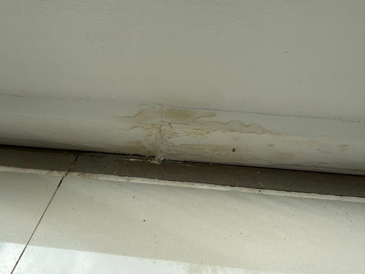

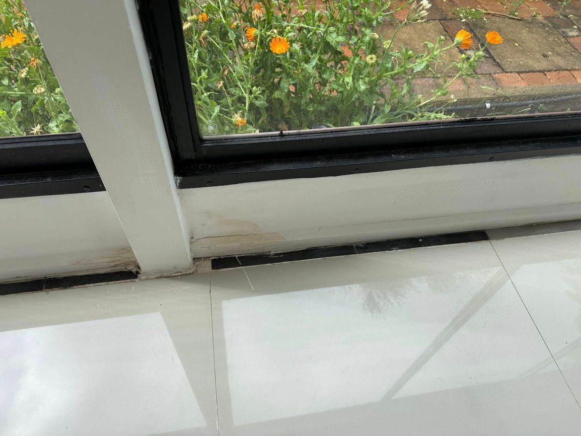

I have a couple of questions about water seeping in sunroom now damaging the skirting board inside.

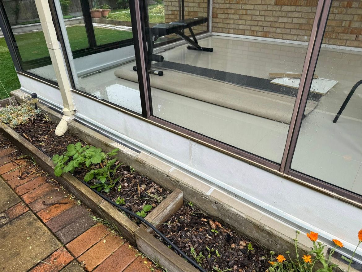

Problem 1: Water seeping in damaging the skirting board. Yesterday I used some masking tape to seal the cracked silicone and grout outside to prevent from the heavy storm, water is still coming in, when I touch the gap between the skirting board and tile in side, my finger gets wet (not just moist). I am not sure if I can just use silicone to seal outside and re grout outside (see the concrete cracks and missing grout in the pic1), or should I also use something to seal the whole white MDF panel under the glass? The exterior white paint is a bit bubbling during rain.
A couple of tiles inside near the damage feel hollow too, but I am not sure it is water damage or just bad workmanship.

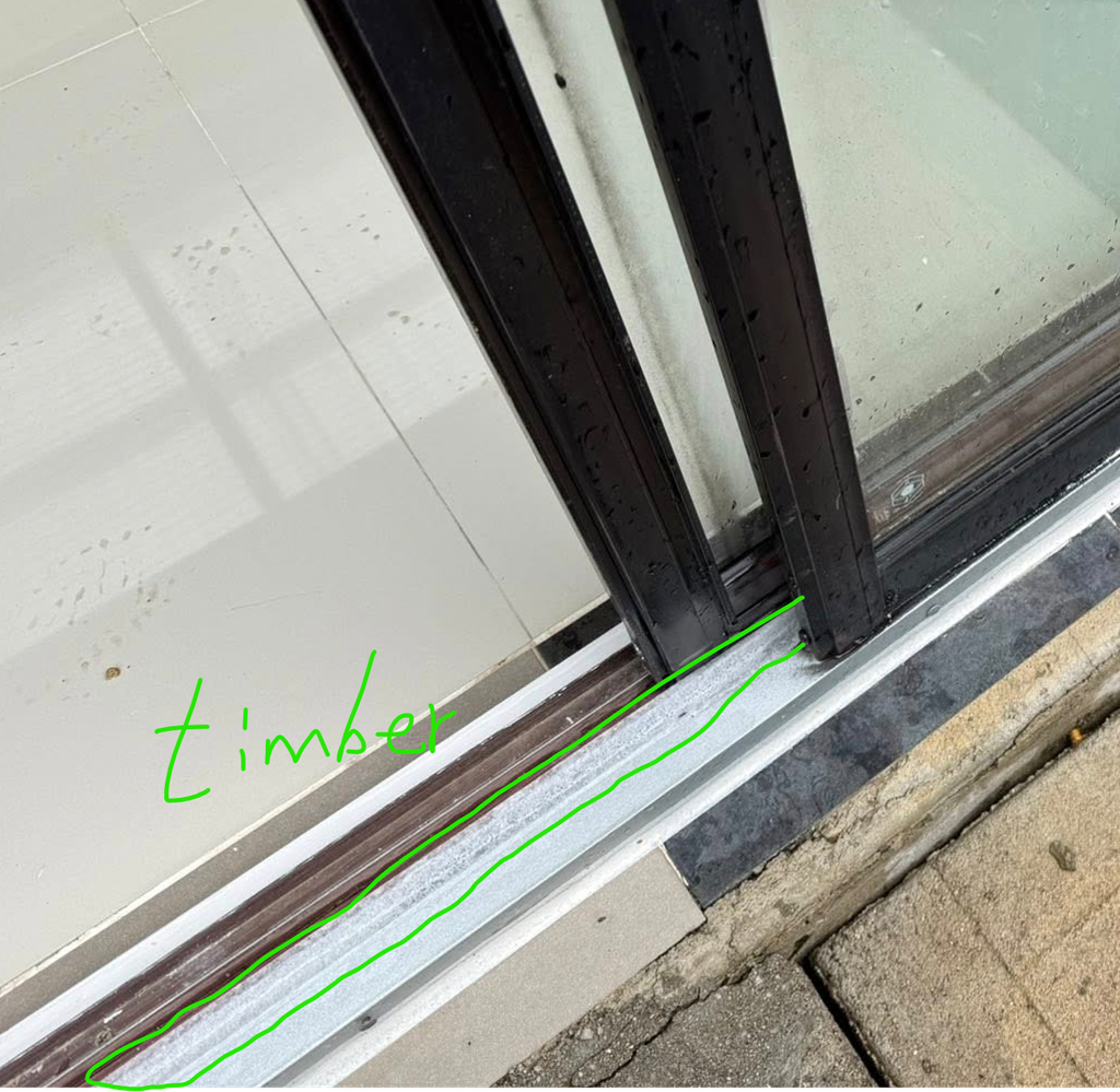

Problem 2, the sliding door is dodge. The frame sill is not completely aluminum, there is a long timber in between along the whole the sill, it gets wet and a little bit sponge so I also used a masking tape to cover it as a super temporary measure.  See pic 4, the circled in green section is the masking tap masking the brown timer underneath.

It sounds like you’re dealing with a fairly significant leak, and given what you’ve described and shown, this really does need a professional assessment. There’s quite a bit of water getting in, and with how those sunrooms are usually built, there are multiple potential points of entry that would make it very difficult to track down and fix with a simple DIY approach. The priority is to determine exactly where the water is getting into the frame and wall, as the issue could be coming from the join between the slab and the wall under the windows, or even through the window tracks themselves. The silicone that’s already been added along the tracks suggests this has been a problem for a while.
Because of the amount of water, it’s likely that there’s damage behind the interior panels, so I’d suggest removing the skirting and the internal wall cladding under the windows to inspect what’s going on behind. That will give you a clearer picture of how much of the timber framework has been affected. If the framing is wet or rotted, those timbers will need to be replaced before any sealing can be effective. Once you’ve opened up that area, it should also help you trace back to where the water is entering outside.
Unfortunately, with many DIY sunroom or patio enclosures, proper weatherproofing and flashing aren’t installed, which leaves them vulnerable to the sort of leaks you’re seeing. At minimum, I’d recommend some exploratory work inside to assess the extent of the damage and then consider bringing in a moisture detection specialist or building inspector to identify the source. From there, you can plan the repair confidently rather than sealing blindly from the outside, which rarely solves the problem long-term.
