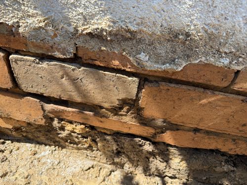

@Dave-1 @EricL @MitchellMc I observed the brick wall has cracks at few places like the one seen in attached pic.
Is it ok if i waterproof direct on top of brick ? Or should i patch this and then waterproof?

The bitumen paint will coat everything and seal any cracks. Your picture shows clay below those bricks? Is there a base the bricks sit on? And can we have a long shot (photo) showing the bricks and trench. I am just wondering if you have dug below the bricks and what they sit on.

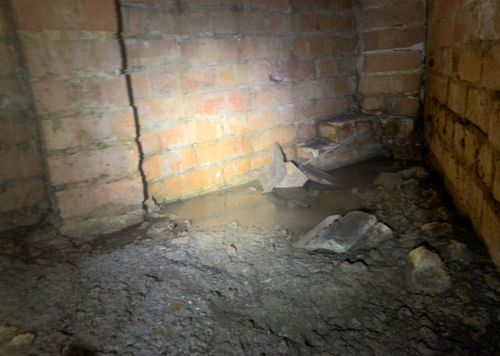

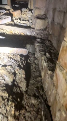

Please check brick wall photos from negative side. As it is a slope, the slab is like steps. The photo where you see water is on the lower side.
Outer wall where I dug the trench , bricks are actually on a concrete slab. But I see it is not extended away from brick. I mean the clay you see below those bricks is actually slab made of concrete + gravel. I will post photos tomorrow morning.

Looks like water leak was through bricks.

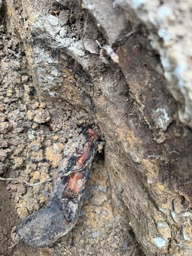

Please find the photos. Not sure you can see slab properly. (Look at the root getting under slab, which shows how strong the slab is. Cut the root and cemented that place as well. Though root goes further)
