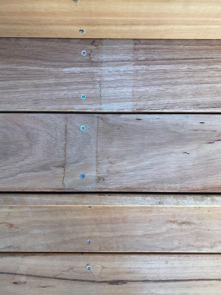

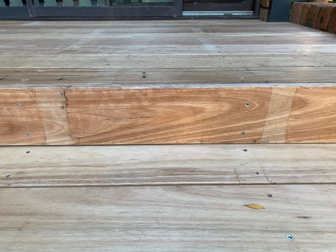

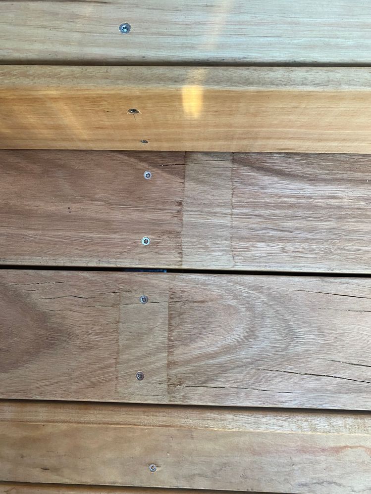

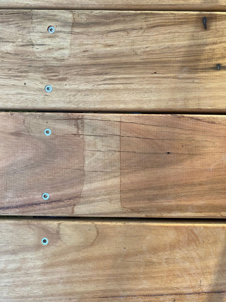

Hi Mitchell, We have just had Bunnings pre-oiled blackbutt timber laid on our rebuilt deck by a licensed builder. On many of the boards there are 5cm wide strips of discolouration. Do you know what could have caused them? And what can we do about it? Thanks, Bill.

Hi @Bunnybill,
I'm not entirely sure what caused it, but it appears to be watermarks. The marks appear fairly uniform, so I suspect they could be from timber gluts that the decking boards were sitting on or from packaging of some kind.
I wouldn't be too concerned; a light sand with some 120-grit sandpaper should remove them fairly easily.
Give this a try and let me know how you go. I am happy to help further if required.
Re: How to treat new Blackbutt deck timber?
Hi Jacob,
If I sand the waterstains will I then have to sand the entire board to maintain a uniform appearance?
Bill
Hi @Bunnybill,
You wouldn't need to sand everything, but you may need to sand a little bit past the area to blend it in with the surroundings. Once you've applied the clear oil you mentioned above, it should blend in well.
If you wanted, you could try using Cabot's 1L Deck Clean before sanding to see if that removes the watermarks. If successful, you might be able avoid sanding at all.
Let me know what you think.
Thanks Jacob. I think I’ll try the Cabots cleaning product first.
