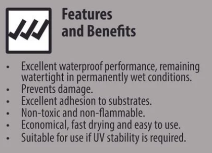

Re: How to turn old firepit into a birdbath?
Hello @JessicaAA
Just to reaffirm what @JacobZ said earlier, both products are nontoxic once they fully cure. You'll see it printed at the back of the can. My best advice is to paint the bird bath outside in a well-ventilated area.
Please remember to wear personal protection such as gloves, goggles and a mask when using this product.
