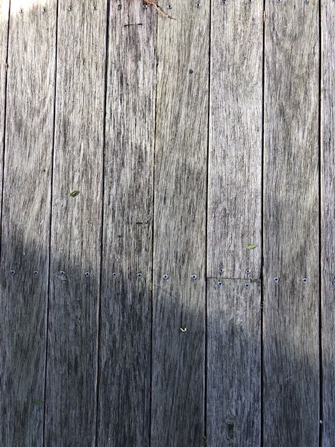

I have 70 square meters of silver top decking that has been down 10 years.  The gaps between the boards have now swollen together and/or have debris embedded.  I have attempted to use a circular saw free hand to re-widen the gap, but I am not steady enough to do the very long cuts required (some up to 10 meters in length).

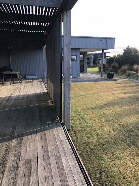

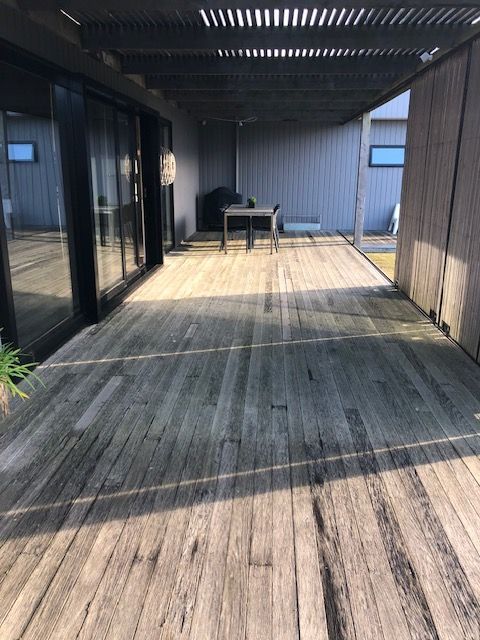

And can you please send through a few photos wide of the deck lengthwise and closer on the issues and how you have been cutting them?

I was wondering if you could supply a few pics of the deck?
One of the deck overall and maybe a few showing the boards coming together/debris type deal?

My bad, but they were laid and left natural when we built the house.   Taking up the entire 70 square meter deck without damaging the boards, then planing the boards and relaying it is way beyond what I can or want to do.
Since posting this, I have looked all over the internet for solutions. There is a company in the US that has come up with a saw guide that is specifically designed to fit on the bottom of the circular saw for doing this job.  Basically, it is a plate that attaches to the bottom of the saw plate that has two fins (one at the front and one at the back of the plate) that fit in the gap and keeps the saw straight as you are cutting. So I am ordering that.
As far as using the circular saw to widen the gaps, I will put two saw blades together on the saw.  This will give me the 5mm you recommend.
Thanks again. I really do appreciate your advice.
Re: How to widen gaps on a deck?
Thanks Dave.  Have a look at my reply to Nailbag. I have also uploaded some photos.
Thanks Eric.  Have a look at my reply to Nailbag. I have also uploaded some photos of the deck.
