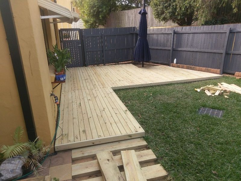

I built my deck at ground level over existing pavers and used the "Good Times" modular decking frames from Bunnings.
 https://www.bunnings.com.au/good-times-90-x-45mm-modular-decking-base-frame-kit_p8451187
They were very easy to put together and very sturdy when all joined up. Mine was just under 14 cm high and leveled it to the back door. You can get adjustable footings to even things out if needed. I then went over the top of that with treated pine decking timber as the cheapest option for me, then stained it. Hope you have fun and love your finished deck as much as I did with mine.
Stuart.

hadi
Junior Contributor
Re: Low profile deck
Hi @Stuardo
Thanks for shring.
This is a great product but I wasn't sure if I can customise the size. Have you done that when you were building yours ?
Also the other quesition is that which type of leg you've installed ? or you just laid them on the ground ? Do you have more pics before laying the treated pines decking boards ?

Stuardo
Experienced Contributor
Hi @hadi,
Yes I did customise, along the fence as it becomes a triangle shape there, but that was easy to cut and allow for.

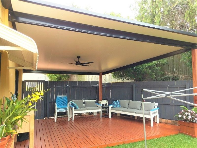

Most of the deck was just the square modules fitting together nicely then some simple carpentry for the angle of the fence. I drew it all up on graph paper first to scale and worked out what I needed to do and buy. I was advised that with the deck being low to the ground I would require a min 5mm gap between decking boards to allow for airflow.
The deck started directly on the pavers at the doorway and only some small height adjustment in some uneven areas and I screwed in steel angle where required to stabilise. The legs from Good Time were too big for the requirements. Sorry I don't have any before photos without the decking boards. Six months later I had a patio cover professionally built over the top of the deck and all council inspected and certified. Best thing I ever did.
Regards,
