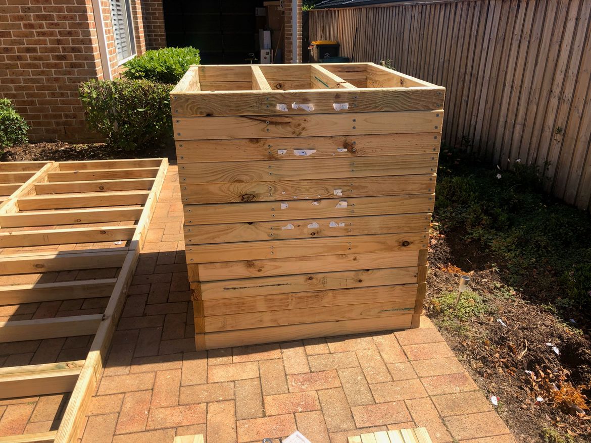

Re: Low profile deck
IMG_0648.jpegIMG_0649.jpegIMG_0621.jpeg57127797390__66D0E21C-4A3A-4B55-B94B-EE38C023B9F2.jpegIMG_0602.jpegIMG_0601.jpegIMG_0599.jpegHi, Sorry I've been busy with the born of my first child. Here some pics of finished deck. I've used the modular decking frame from bunnings and took some of the tiles to put the post in. And for the top used Merbau again from bunnings. Overall very satisfied with the outcome.
Thanks everyone who helped. Without this forum it was impossible.

hadi
Junior Contributor
Hi Jason, Sorry for delay. I've updated the post and added the photos. Hope you like them. Cheers, Hadi
