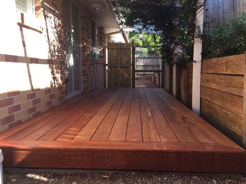

Deck completed!!
Couple months of Saturdays...
Really happy with the results.
Kept it simple as possible
Only issue was fighting with warped decking boards.
Hi @Brendon_B,
Well done on constructing a deck that compliments the area perfectly! I am sure you are proud of your efforts and rightly so as the area looks significantly more functional than before. You'll just need a small 3pc setting and it will be fit for morning coffees whilst admiring your handiwork.

All over it Mitchell...
Thanks to Bunnings....
The deck looks fantastic. I want to choose deck boards with exactly same colour and finish like this. Can I ask what type of boards or stain did you use?
