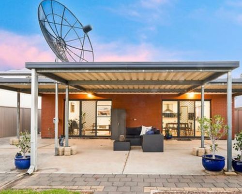

This would be my first deck. Have done some landscaping for myself in the past including a raised garden bed, however nothing major. As far as tools, I've a drill kit including hammer drill, a cordked circular saw and a random orbital sander.
My proposed deck would be 350 x 370 with height from the slab between 17 - 18 cm so it stays flush with the brick and same level as my internal floor.
I've been advised that i could use H3 structural timber (140 x 45) as joists and lay decking boards on top that.
My questions,
1. How do I attach joists to the concrete? Use galvanized angle brackets like this?
2. How can I adjust the height so the finished decking board stays flush? If i used 140 board + .5 bracket + 19 mm board = it would be around 165 cm height. Which is around 1.5 cm lower than bricks. Can I use plastic wedges / window packers to compensate for around 1.5 to 2 cm?
3. This deck would be under alfresco cover and under eaves. In terms for water drainage, what would be helpful. Would the packers / wedges mentioned in Q. 2 help with the same?
Alfresco
Rough plan showing pillar
On the last image, pillar is on the corner of the alfresco slab and the decking to the south of it would be on top of soil (this would 370 x 45 cm). Not much height difference from alfresco slab. What do I need to provide here under joist for support? Not enough height for a stirrup.
