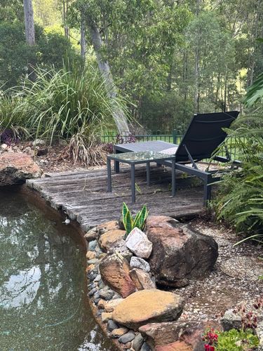

I would love some ideas for new pool decking. Current decking sits on two concrete slabs and each piece of old wood is 2m x 10cm x7.5cm. Open to the next deck being a bit longer (aka 2.5-3m). Our house is a nice redwood brown and would love something rustic or earthy looking to go with the cabin in the woods style of my house.
I’ve been thinking about varnishing sienna sleepers but would love some other/better ideas.

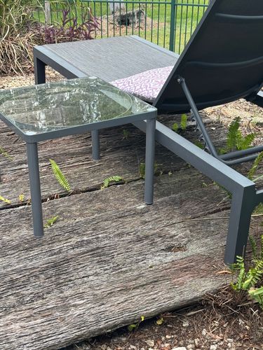

Looks like ants or termites under the old sleepers.

Thanks for this great advice. Do you think the sleepers would need to be sanded and varnished to avoid splinters?

The sleepers come rough-sawn for landscaping purposes @KimN. So, there's a good chance of splinters, and sanding would help reduce them.

I like the hardwood sleepers, somethinga round the 50mm thick mark and probarly 2m or 2.4m long if possible. Sanding them back to remove the majority of the splinters would be worth the effort. I would oil them over varnishing as I feel the protection lasts longer and wont flake as varnish may with time. You would have to re-oil every year of so for awhile. It really protects the timbers outside when I have oiled them regulary (yearly). I would also add some some support rails and screw the sleepers to them so the timber sleepers are not touching the ground.
I do like the natural look you have, right down to the greyness of the old sleepers. I just had a thought to adding a gabion bench seat with timber top to the end of the decking area to deliminate the area and also a useful edge.
Gabion wall bench seats is the project as an example. It still retains a rustic look especially if you fill the cages with local styled rock. I have used sandstone for other gabion walls (faced the front of the cage with scrappy rocks inside the cage) and they look brilliant. If you look at my bookmarks you will find them there. I have just finished a larger retaining wall style with a timber top as well. (yet to be posted) For both cages with timber tops I used recyled old hardwood from house knock downs and they have held up well.
