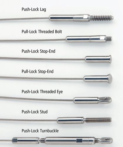

A couple of questions for anyone with experience in wire balustrades.. I don't want to buy the kits from Bunnings, because it works at way too expensive, but there are other suppliers (such as http://www.hammersmith.com.au, and http://www.allthingsstainless.com.au), who have multiple different 'systems', where you buy each part separately..
Owing to the fact that the deck is pretty small, i'd like to use a system with small fittings (ie: so that the length of wire is not dominated by a large turnbuckle, and large fittings at each end)..
Any suggestions?

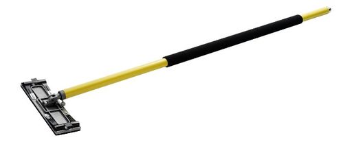

If not spot sanding, do you think it could be worthwhile carrying out a light sand of the whole deck area, using say, a pole sander like a painter would use? Or would this also produce a poor result?
If so, would you recommend a fine sand paper, say 120grit?

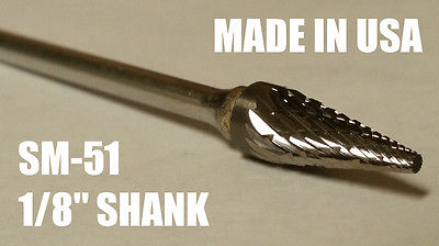

Burr
Something like that will fit in your drill and you can run it around the inside of the hole. assuming that the screws arn't flush.

Looks great.  Good work.  With regard to your balustrades, I would just pick something that you think looks and works.  As stated, there are just too many to choose from.  To save on fasteners, you could drill through the posts and thread the wire from end post to end post.
*****Just make sure the spacing between wires is to code as I am pretty sure there is a minimum/maximum spacing between wires (you don't want your little ones slipping through the gap).*****
