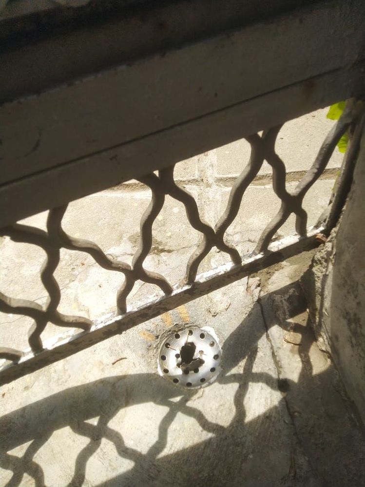

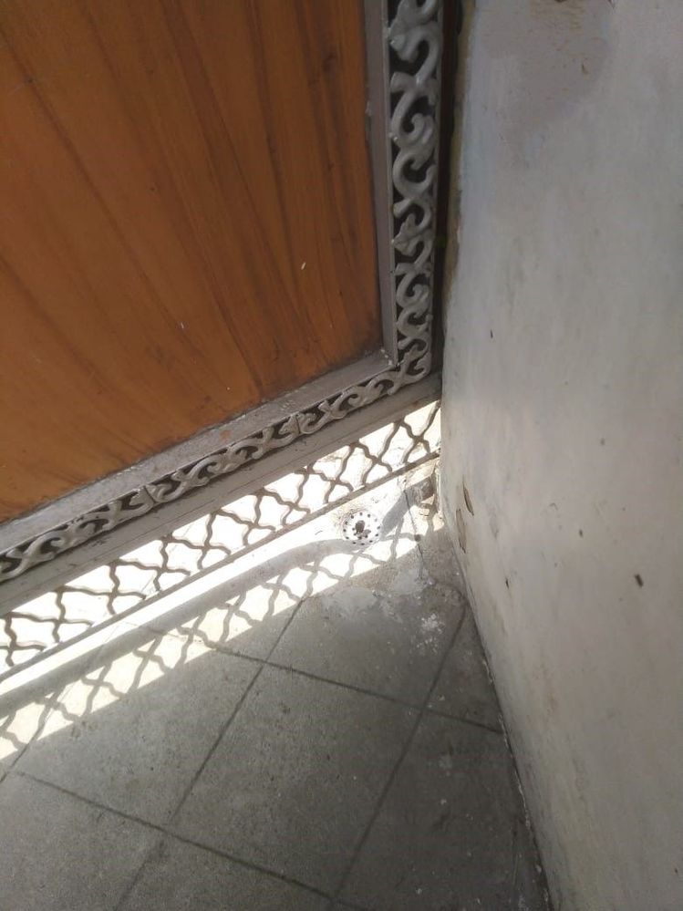

I have got more photos, of the entire gate and the closer pictures of the drain.
And closer one for the drain.
Good Morning @kingj
Thank you for the extra photos, and yeah straight up I can see why there is an issue. The drain is very much too small for the area 😕 The last photo shows newer concrete and it looks like some work has been dont to after the install?
I would suggest to break up that new concrete around the drain and replace with a larger width grill structure. The concern I have is the pipe that the drain is connected to may be too small in size to carry away all the water from the driveways surface. This would also explain why water backs up apart from the drain itself becoming clogged with leaf matter.
Larger drain intake and check the size of the pipe and where it runs to would be my suggestion.
