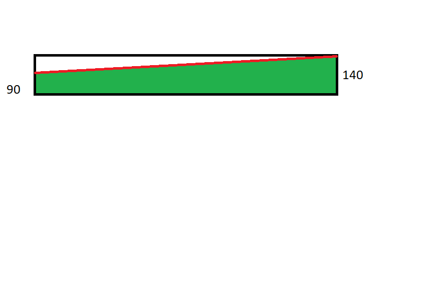

I'm trying to build a 6x3.5m pergola, the span of the rafter will be roughly 3.5m at 600mm spacing.
The idea is trying to create a level enclosed ceiling underneath and a pitched roof between 1 and 5 degree towards the front of the gutter. The whaling plate will be fixed to the existing house structure.
My question is can I use one rafter for both ceiling joist and roof rafter to support metal sheeting, I'm thinking to use 140mmx45mm H2 MGP10. Is it possible to rip the top of the timber at a small angle from one end to the other to create that slope but at the same time to keep the bottom straight use for ceiling joist? I attached a drawing for your reference, green part to keep.
Thanks

I want to know if 3500mm span for the ceiling/rafter joist is safe to use 140mmx45mm timber?
Re: Pergola ceiling joist & rafter question
Hi @jasonlee,
For a span of 3500mm you'd need to go for at least 190 x 45mm. However, if you then want to cut it down to achieve that slope, you'd have to step up to 240 x 35/45mm.

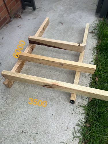

Can I have 2x3.6m support beam overlap each other around 600mm for the 6m span?
Would you possibly be able to draw a sketch of what you'd like to achieve, @jasonlee

So I get you want to shave down one end of the beam so that its level with the ceiling space you are creating.
Having a 5 degree drop is the first part I question, thats not a surface that will help water drain especially if you get dirt and leaves in your area.
Shaving off the the beam will make it weaker. Instead of doubling the height of the beam as I think you are height poor for the space, how about having two beams side by side chamford the way you want them. That way you still get the strength, plus the angle you are after?

This is what I’m trying to achieve, support beam and roof joists acting both rafter and ceiling joist.
If I want to separate the roof rafter and ceiling joist which I can, do I need to build a dawrf wall or something at the back so the rafter can fix on to a new walling plate? Because the support beam for the pergola is free standing, there is no structure for me to fix the walling plate onto. That’s why I was trying to use just one beam for two purposes.
