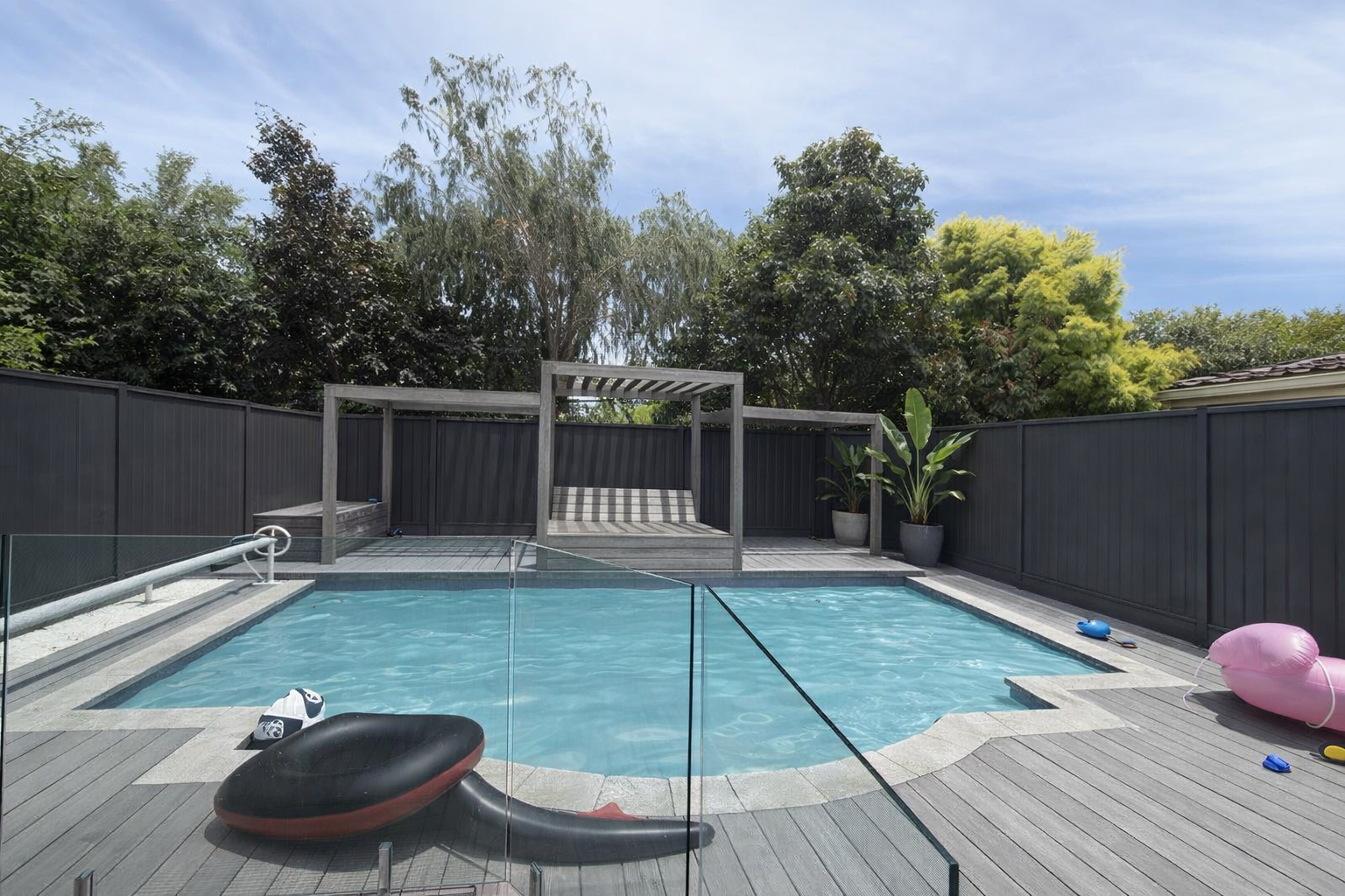

Here's an AI-generated image for some inspiration.
