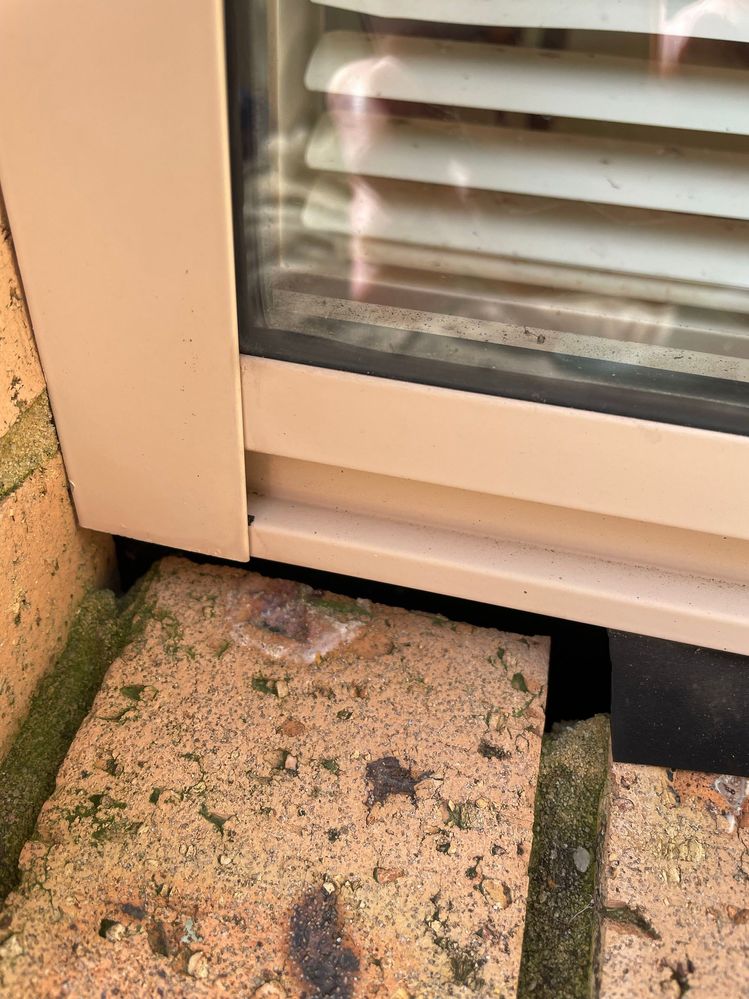

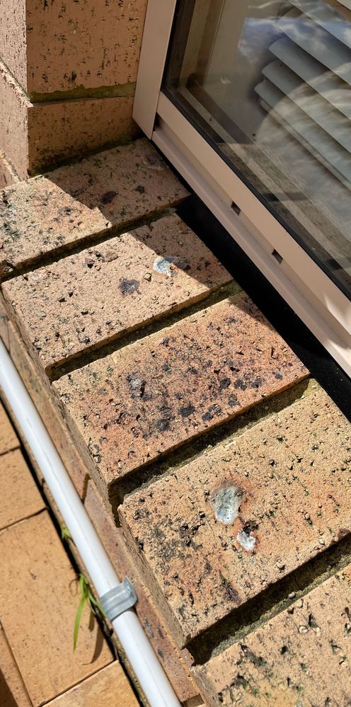

The bottom window's external rubber flashing has worn on most the windows in my home.
The images show one larger gap, but most windows have this strip torn to bits.

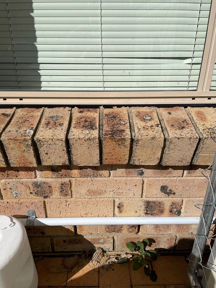

Hi @Rob001,
If you have a look at the mortar lines under the bricks that form the sill, do you see gaps in the mortar?

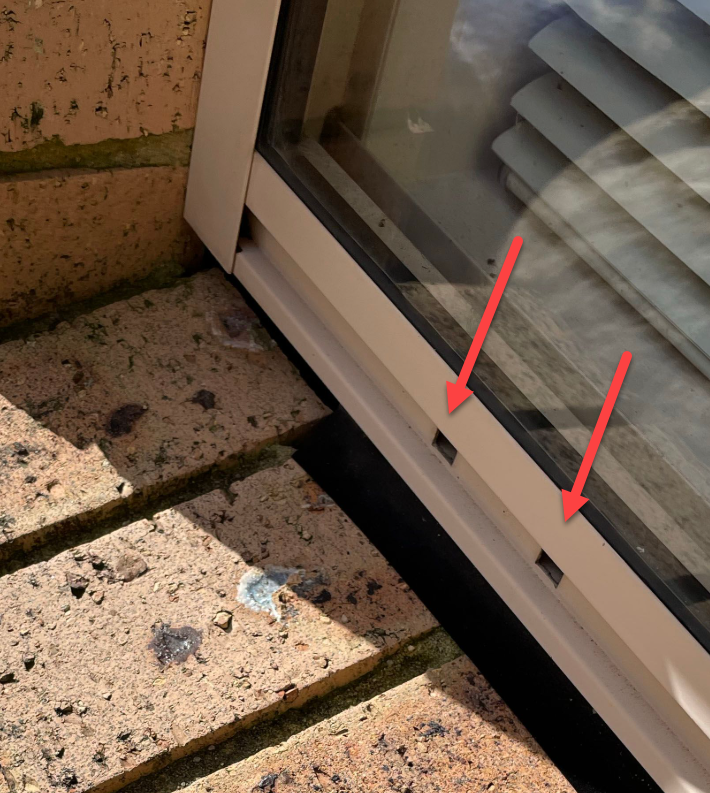

In a double brick installation, which I am pretty confident your house is, there should be a flashing that runs from the underside of the window frame into the mortar on the underside of the sill. There will usually be weep holes here for drainage.
There are also weep holes in your window frame here.
As long as sealing the underside of the window does not block these holes or the weep holes that are likely below the sill, then you won't have any problems.
Let me know what you find.
Re: Replace bottom window external rubber flashing
And if I choose to silicone, do I cut off that old rubber flashing or can I silicone over it?
There are weep holes in the brick under the windows. I think this is what you're referring to?
