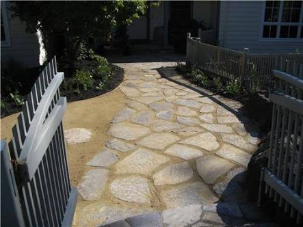

I've seen the granitic sand used and it can look really good.
Here's a great example of being used with crazy paving:

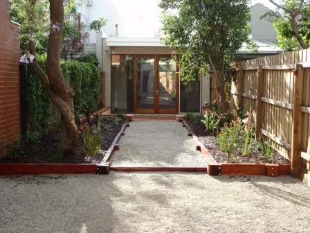

The concrete got ripped up yesterday and some roadbase has gone down as a temporary measure and a foundation for whatever we choose.
Here's a shot of the space. We're thinking of planting directly into the sand.
