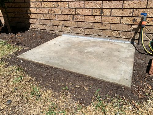

Hello,
I recently poured a concrete slab and it’s off level in the centre causing water to pool. It’s deteriorating the concrete and only going to cause more damage over time. There’s going to be a water tank (1000l) going on top. Does the slab need to be broken out and re-poured? Or can I use a screed to bring it up to the surrounding level?

You do not necessarily need to break out and re-pour the slab, but the best approach depends on how far out of level the centre is and how much material you would need to add to correct the fall. A small depression can usually be fixed with a cement-based screed, which can bond well to existing concrete as long as the surface is sound, clean, and properly prepared.
If the depression is deeper and you need to build up more material, you would be looking at a structural grout and a primer made specifically for bonding to old concrete. The surface must be roughened, cleaned thoroughly, and free of any laitance or loose material. Once properly prepared, a bonded screed can form a durable topping that restores the correct fall.
The main question is whether the slab is strong enough overall to support the 1000 litre tank, since that will add about a tonne of weight. As long as the original slab is well compacted, not cracked, and thick enough, adding a screed topping to correct the level is acceptable. If the slab itself is poorly made, very thin, or already showing signs of deterioration beyond surface wear, then replacement would be the safer option.

The area in total is around 800mm x 600mm. It falls to about 5mm at its deepest point. Everywhere else is nice and level. A cement-based screed would be the best option then? I don't need to build up the whole area but if it means it's going to have more integrity, then I'm more than happy to do a structural grout and primer.
The slab is just over a 100mm thick with 50mm of road base beneath the slab. There were no signs of cracking or the like around the edges, just the top has signs of pooling.
A cement-based screed just over the depression would do the job @HardYakka; no need to go over the whole area.
