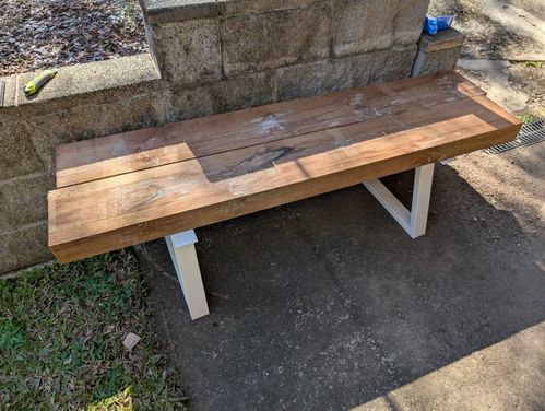

Purchased some Sienna micropro H4 sleepers to make a seat. Note I haven't attached the legs just included in the picture to give a rough idea for what I'm going for
Issue is that the timber has definitely seen better days. Wondering if it's okay for me to sand this timber down? If so any recommended tools to make the job quicker and easier?
As well as might potentially stain it to give it a nice look. Any good recommendations for products to use that will remain safe to sit on?

Thank you for your patience. Our supplier has relayed to us that they don't recommend sanding the surface of the sleeper as it will lessen its protection.
As an alternative, I would recommend using non-treated hardwood for your seating project. A good example would be 140 x 19mm 5.7m SpecRite Merbau Joined Set Length Pre-Oiled Decking. Although not as thick and bulky it can be constructed in such a manner that it looks like it has a thick side profile.

Thanks Eric! Appreciate you looking into this
I ended up going back to Bunnings and picking out another piece of Sienna timber for this seat
But will keep the Merbau in mind for next time as it's definitely a good alternative
