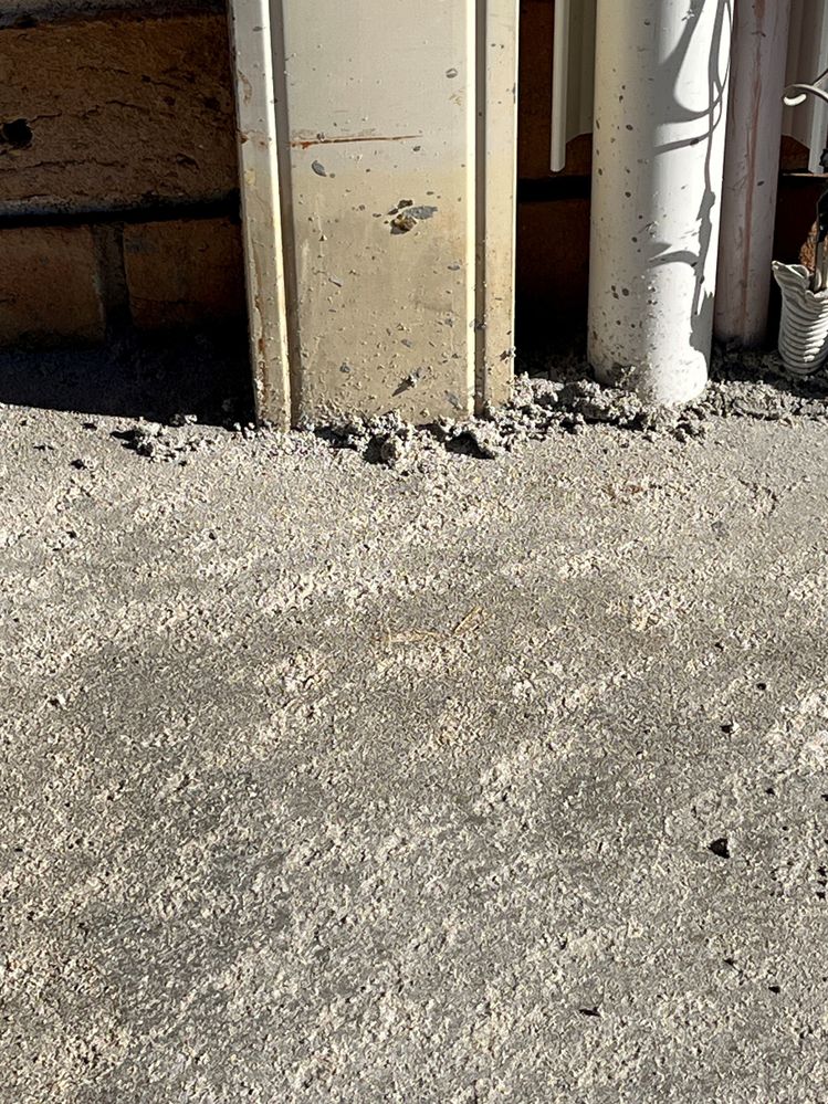

Hi, I had some concreting done, and my downpipe adaptor is now slightly below the concrete surface.
The adaptor is the same as my 1st pic, I can remove the downpipe easily enough.
I was wondering if there was a rectangular shape extension that could be inserted into the adaptor.
I'm about to be getting tiling done and want to sort this out before that.
Thanks,

Hello @pipersdj (David)
