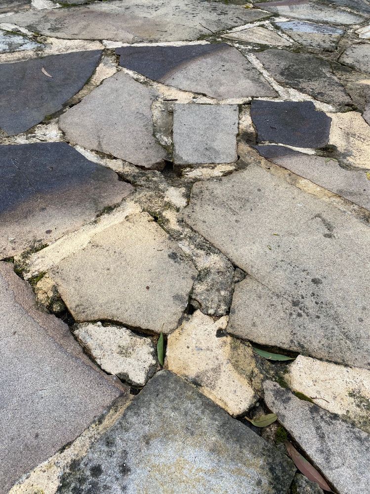

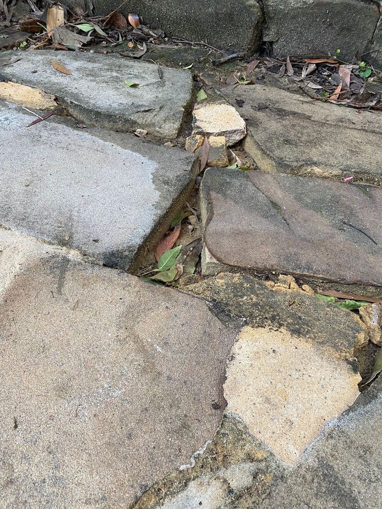

We have just had our outdoors cleaned and when pressure cleaned some of the filling between our sandstone pavers has been removed. We would like to attempt to tackle this ourselves but are unsure what to fill in between the gaps with. Some areas are larger and others are just small gaps. We are not at all handy and are looking for the easiest option that won't look terrible.

Due to some of the large gaps in your pavers, I suggest using Dunlop 15kg Mid Grey Wide Joint Grout. Please make sure to use personal protection such as gloves, goggles and a mask when using it. Please note that colour of the mixture mid-grey and will not match your current grout colour. My best advice is to make sure that the gaps are clean and free of debris.
Here is a handy step-by-step guide: How To Lay Crazy Paving (the grout technique is applicable to your project)
