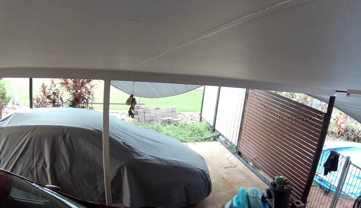

Any ideas for screening that is weather proof? I have a side verandah/open carport that gets the afternoon sun and rain. I would like park my car there so need something that will stop the rain and also sun. I would prefer something solid that I could put between my existing verandah posts. Not a good photo but the space is the edge of the concrete is where the existing roof ends and would like to have something there to protect the car

Can I trouble you to upload some photos of the location you're hoping to install your screening? It would greatly help us to understand the space and offer recommendations.
How far apart are the posts?
I am assuming, based on prior experience, that the posts are likely somewhere around 2.4m apart, which is not ideal for any kind of solid screening or cladding, and it would likely require you to install additional framing. It is certainly possible, but it would require additional work, and I'd need to see what you've got in order to recommend a solution.

Hi @rmjaln,
Same as @JacobZ please post photos so we can recommend one or more screening suggestions.
