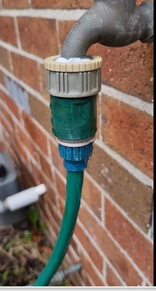

The hose at the tap end does leak a little bit. I have attached a pictureOzito pressure washer tap leak.jpg for reference.

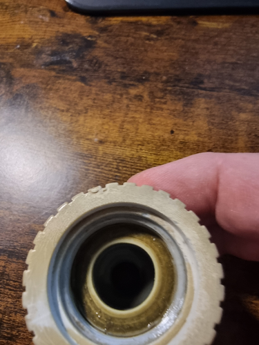

I unscrewed this:

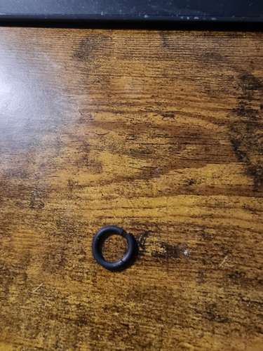

And found the o-ring snapped:

There’s a bit to unpack here, Nick (@sera2775). The first thing to address is the fitting where the o-ring has snapped. That will need to be replaced, or you can just replace the entire connector with a new push-fit (click-on) type fitting, which is usually the simpler option. However, that broken o-ring isn’t likely the main reason the pressure washer is cutting out. A small leak at the tap or hose end usually won’t stop the unit from running, as long as there’s still a steady water flow reaching it.
Once you’ve replaced that fitting, double-check your hose for kinks or restrictions. Turn on the water at the tap and make sure there’s a strong, full flow of water coming through the hose before connecting it to the machine. Then reconnect the hose, turn the water back on fully, and allow the water to flow through the washer for a few seconds before switching on the power.
